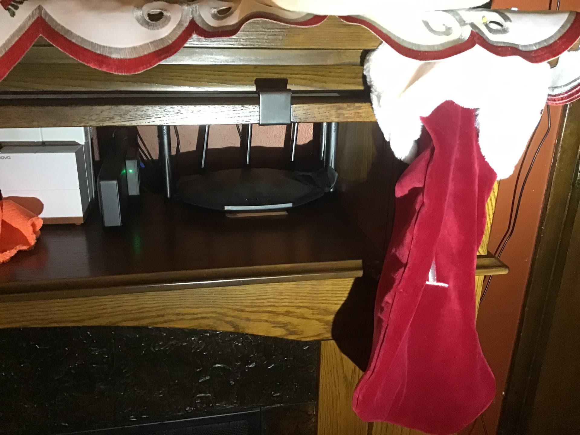

My HE hub is less than 3โ€ away from my Tenda AC23 router. To its right is one node of a Tenda MW6 mesh. Sitting on top are two Wyze outdoor camera base stations that are strictly 2G. It has been like this for over a year with no issues. Of course, as soon as I hit โ€˜Replyโ€™, the demons of Zigbee and Z-Wave will be awakened to wreak havoc.
The HE hub is attached to a RAVPower USB power bank that provides uninterruptible power to the HE hub.
