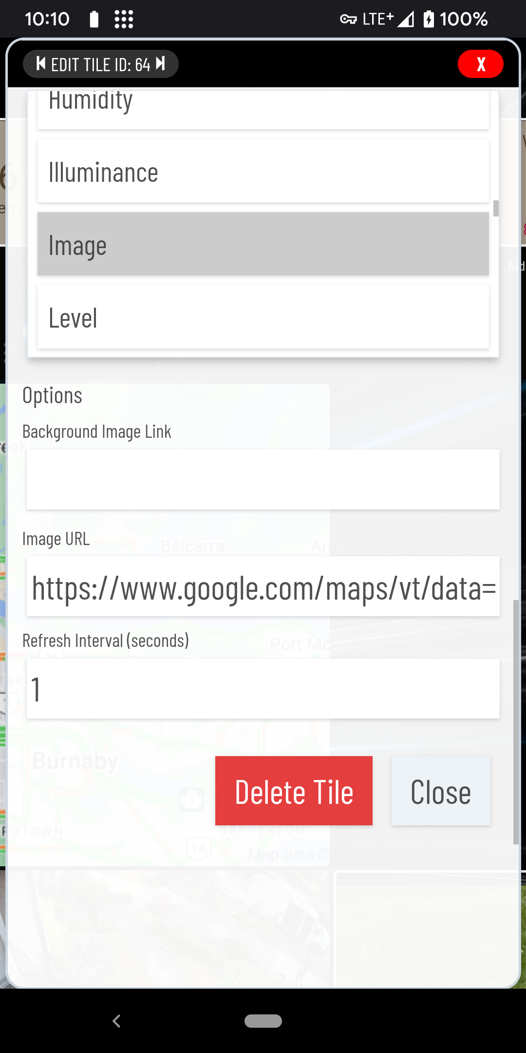

You can display your html link on an image tile.
Here's an example of my Google traffic map.

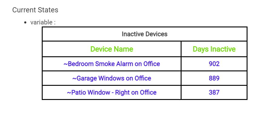

That was where I started a few days ago. Now I'm here.
And after a little more time I am here and most of the elements are customizable.
I'll be publishing my app in the next day or two so you can always wait and grab my code if it's helpful.

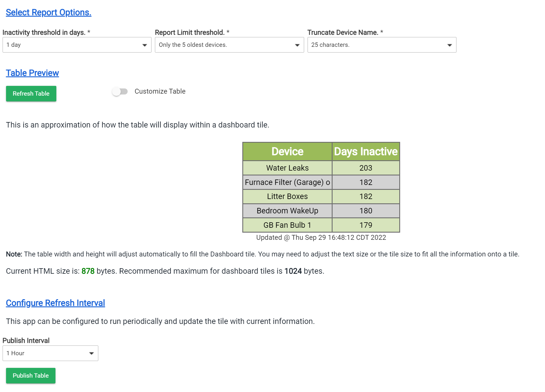

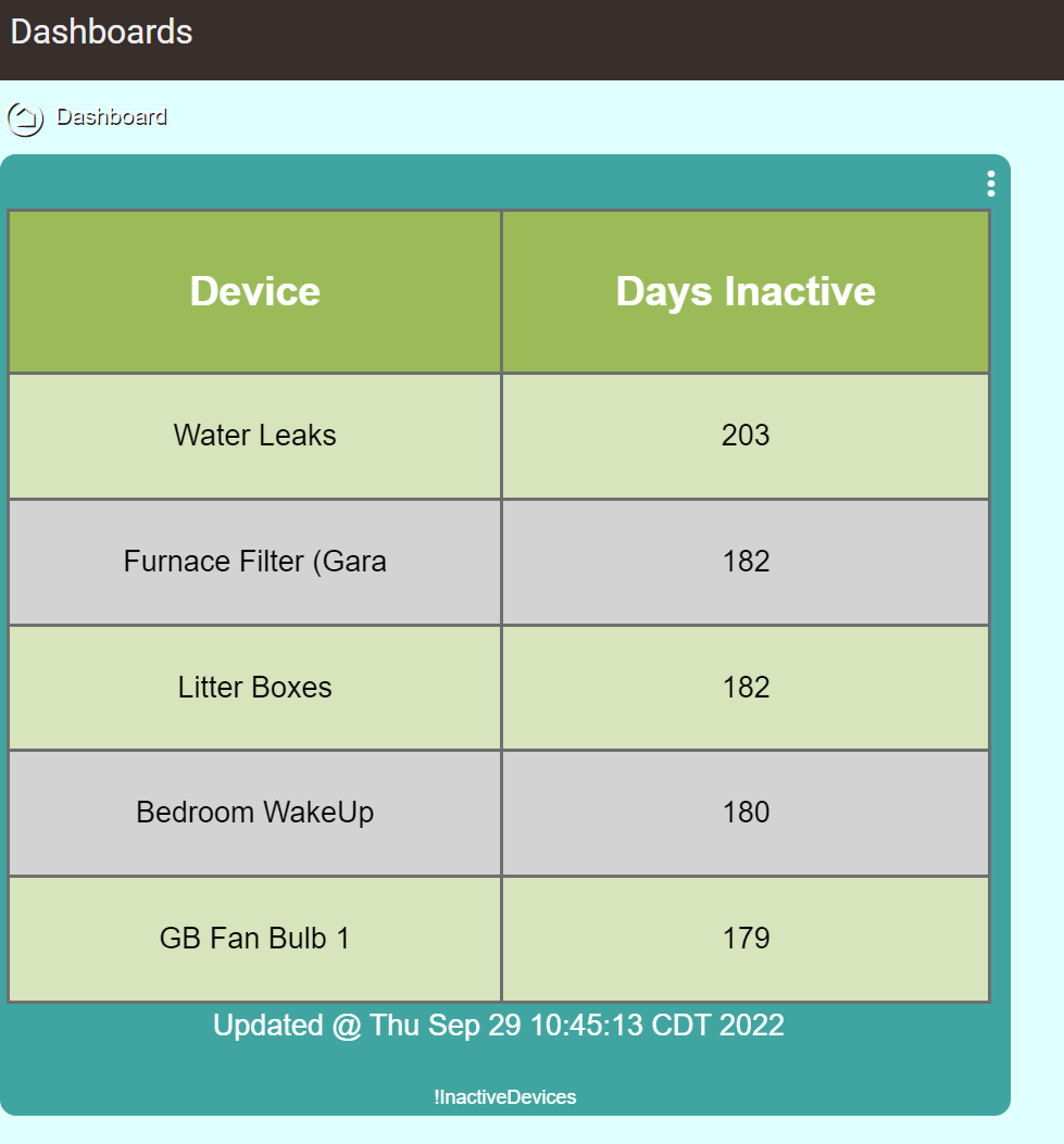

Hi, all good ideas. This is where I'm at.
Because the device attribute is limited to 1024 characters it maxes out at about 10 rows of data it's pretty easy to take in at a glance. The more complex the HTML the less room there is for data. I'm of the opinion that this should be empty most of the time and that the presence of a device is probably an actionable event. But that is just personal preference.
I doesn't show on this screen but you can select the devices to monitor and you can have multiple instances of the app so you might have one instance for battery devices and a low inactivity threshold. A second instance might be plugged in devices with a higher activity threshold.
I do plan on adding a device link but have not got to that yet. The origins of this for me is that I have battery devices that die claiming they still have 100% of charge. Even quality devices like Samsung typically die at around 50%, so clearly using battery level as a pre-cursor to device failure is not a reliable method. So I took the approach of, how can I find out quickly if something has died.
I did try Device Watchdog and while it is very comprehensive I found it to be rather weighty with multiple apps, drivers and devices. So I wanted to do something lightweight hence this app that uses the built in Hub Variable as it's data store.
