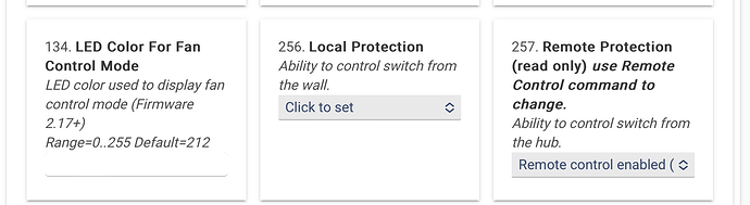

I think what you are looking for is command 256 (Local Protection):
Do you not have that as an option in your device driver?

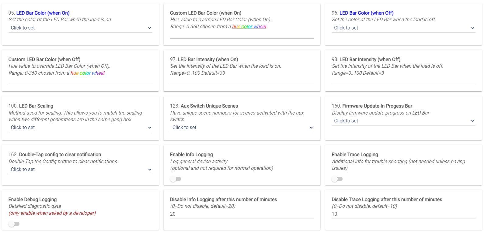

You seem to have a different driver than I am using. I am using the V2 driver from the HPM app.
Below is what my preferences look like in the numerical ordering that they appear. I have nothing beyond 162. After that it is all logging, trace and debugging options.

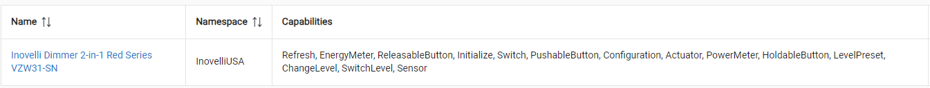

May I ask, where did you get your driver or what version you are using? I have included my driver below as well.
Looks like mine is dated: 2024-03-21
From HPM’s “View Apps and Drivers” screen, I get this version number (Gen 2):
v24.3.21

  • Inovelli Drivers (Gen 2) Documentation
    • Inovelli Dimmer 2-in-1 Red Series VZW31-SN v24.8.7 (driver)
Blue vs Red
Blue is 24.3.21
Red is 24.8.7
According to the HPM manifest.

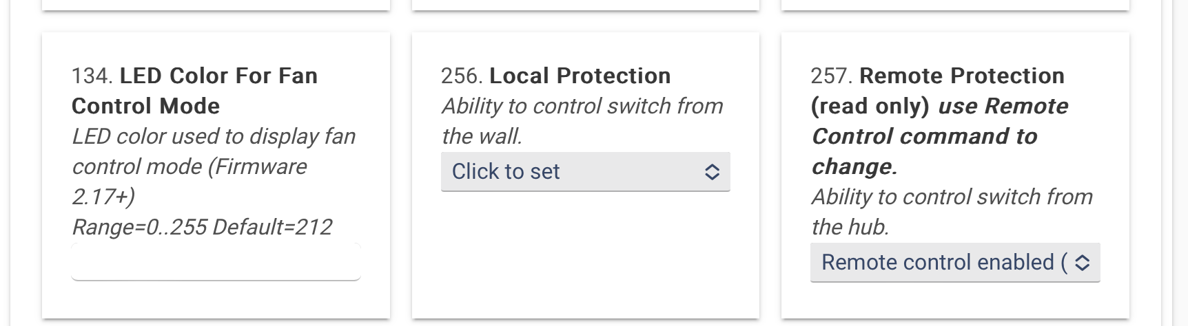

Interesting. Thank you. @Sebastien are you running the Blue or Red?
  • Inovelli Dimmer 2-in-1 Blue Series VZM31-SN v24.3.21 (driver)
Good catch @csteele! I have 1 red, but it hasn’t been installed yet. I missed that « M » in my driver name vs the Red’s « W ».
That said, I wonder why that functionality is in the Blue series, but not the Red series.
Great question! I have a ticket in with Inovelli to find out! The only reason I bought them was because I had the ability to straight out disable the rocker.
Just letting you know they updated the driver to provide the functionality. I noticed an issues on the parameters page under the device where the parameter doesn't update on that screen when it is changed by a rule. This only applies to Parameter 156 which is the disabling of the physical switch. I change other parameters and they update.
