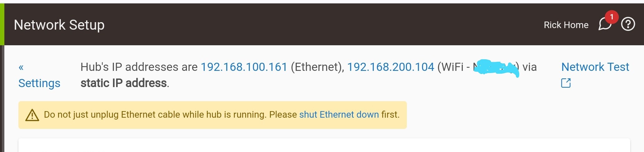

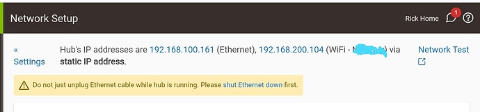

If you don't want to have a Wi-Fi connection, simply disconnect the Wi-Fi. These images might help. Note that the first image shows that my Ethernet and Wi-Fi are actually on different subnets.

It's been several months since I originally setup my hub, so I don't recall the steps that I took.
