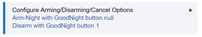

And for some reason I'm getting this
when the detail screen shows this:

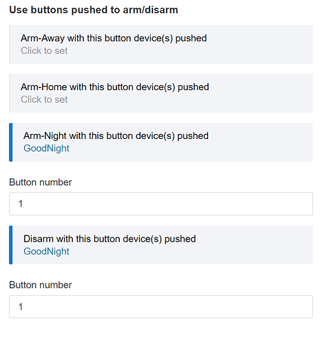

The problem seems to be the null for arm- night....
I'm using a switch and followed the doc that says to plug in "1"

Replaced the switch with a button, still seeing the null for arm-night.
It is configured as button 1... just like the disarm.
@bikesquid I have updated my device to the newest version (2.0.2.111) but I get the same problem as you. Arm-Night always gives "button null".
Did you find a solution to this?
Ah, I just found a typo in the app that explains this problem. A fix will be in the next build. This fix will require that you reselect the button number for arm-night after you do the update to the next release.
