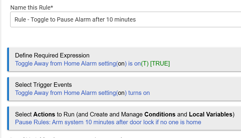

Thanks for the suggestions. I created the virtual switch and rule but done think it is working. When I turn the switch on and look at the rule, it does not show that it is pause. Thoughts?
Your Required Expression conflicts directly with your Trigger. I would just dump that Reqd Expression altogether.

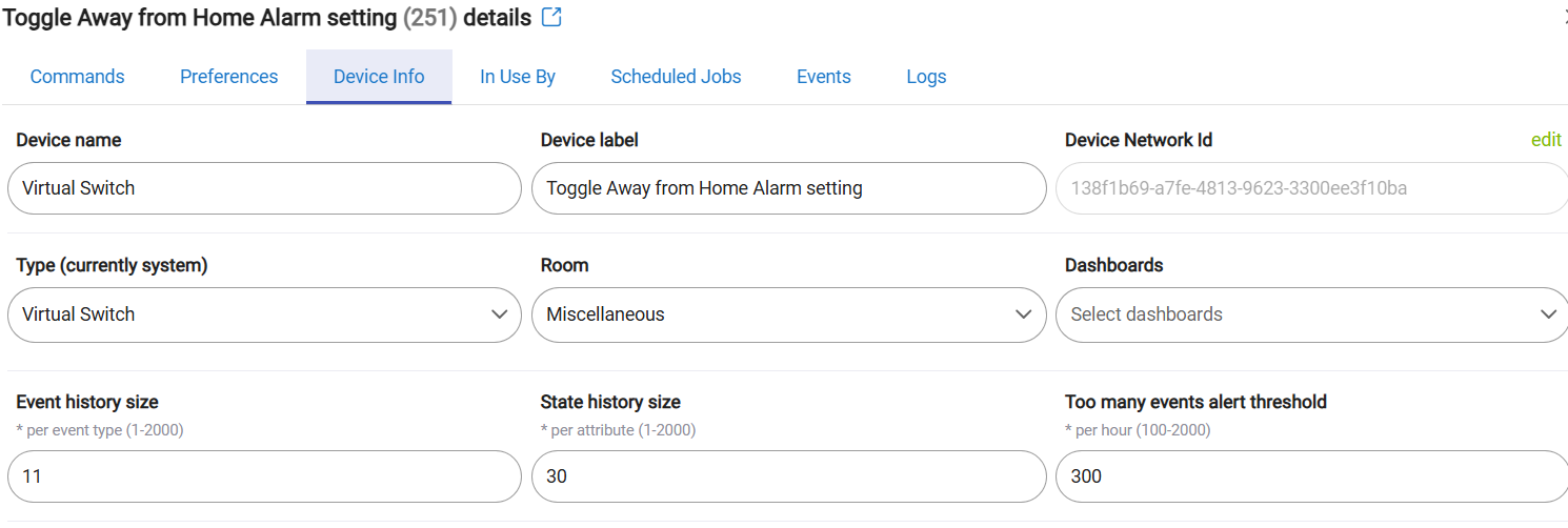

Is your virtual switch a plain vanilla on/off switch? It shouldn't be a Button device or anything like that.
I just tested my pause/unpause rules, and they still work fine.
It is a virtural switch.

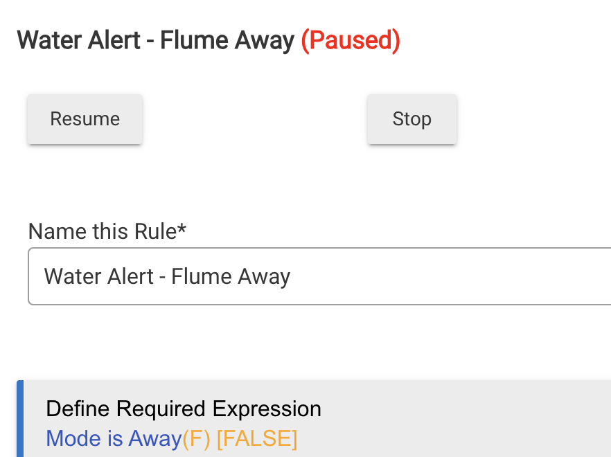

You're not going to see any state-related information about the target rule in the rule(s) you have to pause/unpause it.
To see if the target rule is paused or unpaused, you need to look at it...
Devices page view:
Screenshot 2025-10-20 at 08.51.37
Target rule's own page view:
