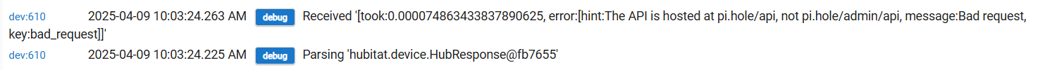

I'm wondering if anyone else has successfully implemented a way to temporarily disable ad blocking from a PiHole through the trigger of a virtual switch in Hubitat. I used to be able to accomplish this using the API in PiHole version 5, but the API for PiHole version 6 is completely rewritten and a bit over my head. The documentation for the PiHole API is here http://pi.hole/api/docs/ . I've asked ChatGPT to help create a Hubitat app where I turn on a virtual switch and it sends the appropriate API command to the PiHole (app code below).

However, with this app I keep getting this log in Hubitat.
Any help would be very much appreciated! Thanks!
