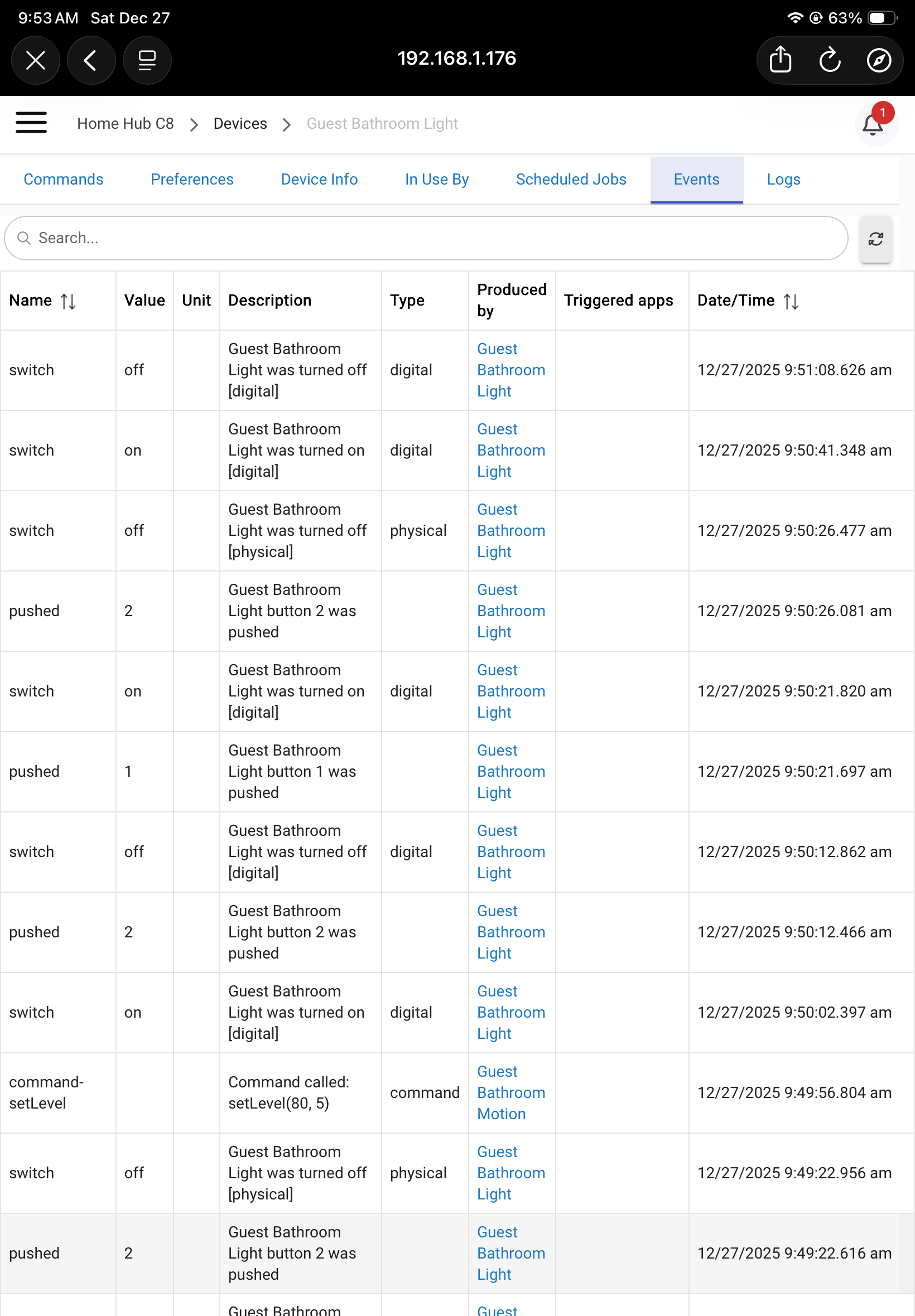

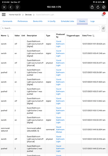

Hello, thanks for the reply. When I was having the issue I removed the device from HomeKit and the echo skill. The only in use by app was my simple automation which I even tried removing and recreating. Attached are the logs when troubleshooting but tbh can’t remember if I had debug on. You can see the physical button pushing to turn off and within seconds turning back on until I turned it off digitally, then it stopped. Nothing changed on the zwave network for months prior to this, been running fine and out of the blue this started.
If one device I’d just chalk up to a weird rare issue but twice in a month after being so stable and on two different devices is just odd.
