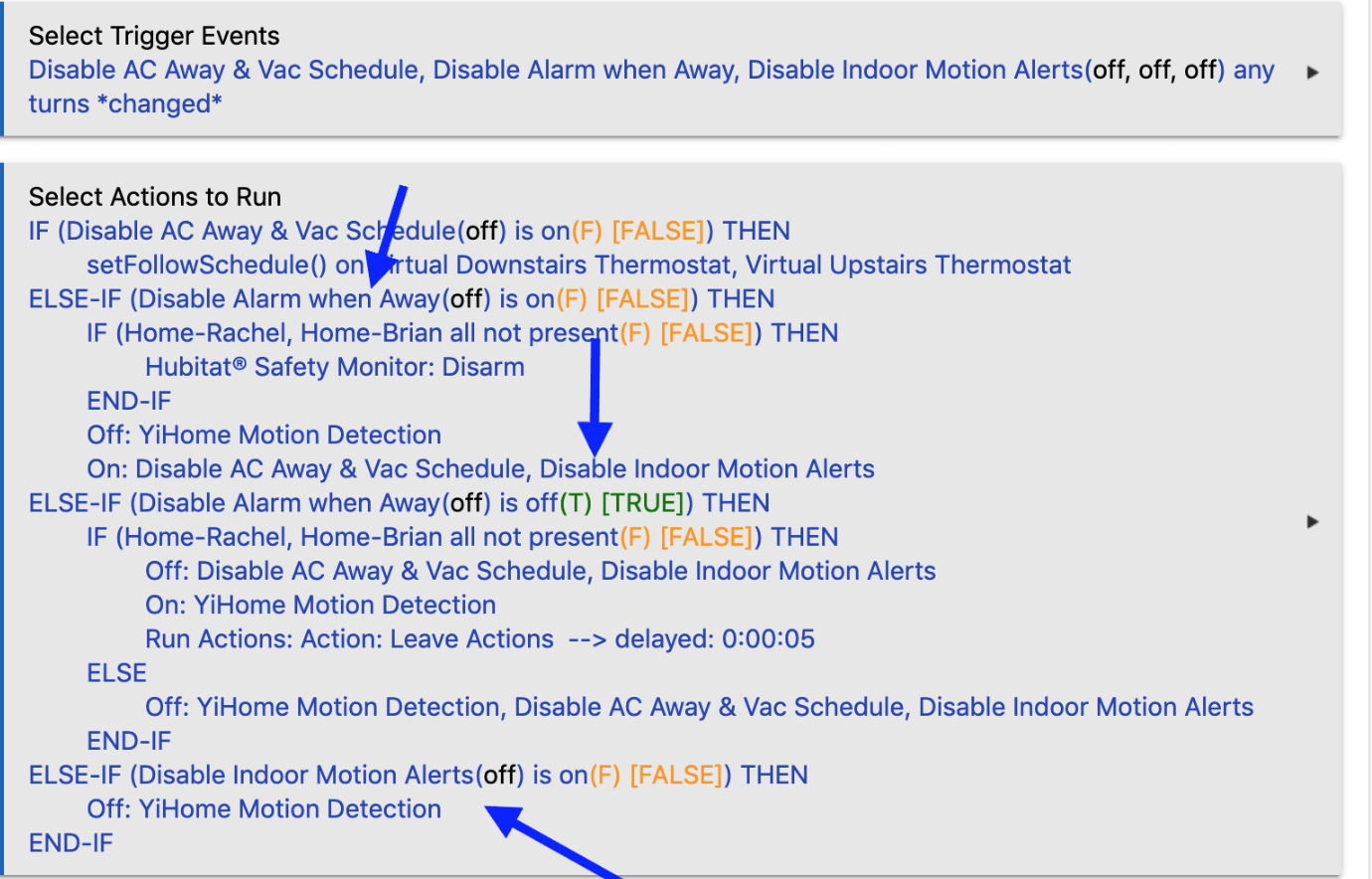

Was attempting to convert this simple rule to RM4 to get my feet wet:
But I've been unable to find the "Run custom commands" option. What am I missing?

Its replaced by Custom Action.
Instead of pre-defining "custom commands", as was done before, you just put the custom action to run right into the actions for a rule.
Thanks. Can you also have an if statement that sets a switch that would trigger the same RM action to run again?
For instance, if I turn Disable Alarm when Away ON, it turns Disable Indoor Motion Alerts ON which would then trigger the same RM rule to run again, but call a different function. My concern is that RM rules calling the same rule again would result in some infinite loop.

Well, I suppose. But you run the risk of an infinite loop if you don't do it right. It's also possible to create a bad situation with simultaneous instances of a rule. Embedded delays can cause this with multiple triggers. So you have to be careful.
Cardinal rule for good automations: KISS
