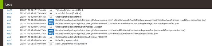

Here's what the log shows around the time of the big increase...
The same sequence of log entries are shown at midnight for previous days, but those days don't show any corresponding memory usage increase like the one that happened last night.
