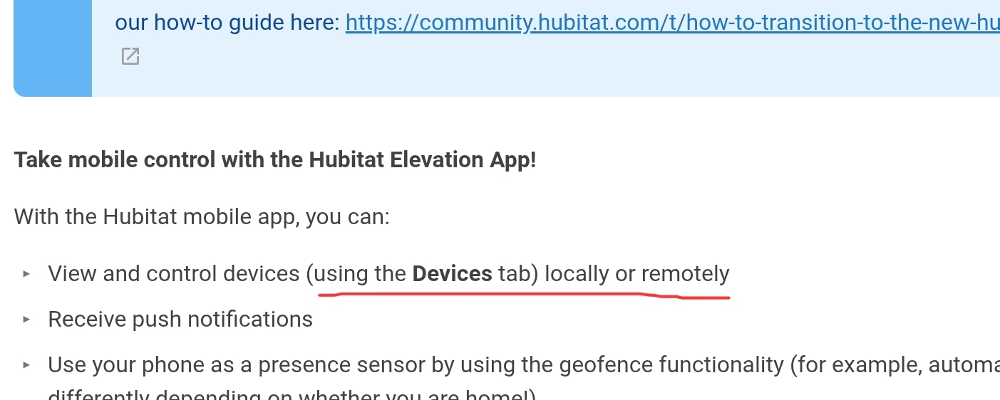

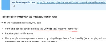

  • NOTE: Remote Admin is an optional subscription service and is not required to access your hub from a local network or use built-in cloud features like remote Dashboard access
I've never seen device management available without remote admin. The Remote Admin page still says that is a feature it gives you.
You can securely administer all your Hubitat Elevation hubs with an optional monthly subscription to Remote Admin. Easy remote administration enables you to set rules, manage devices, and adjust settings while away from home.
Device control is possible from the mobile app, with or without a remote admin subscription.
Access to the hub’s primary/local GUI for device administration (e.g. to change device settings/parameters etc.) requires the remote admin sub.
It has always been dashboards and the mobile app that use cloud connections from outside your network:

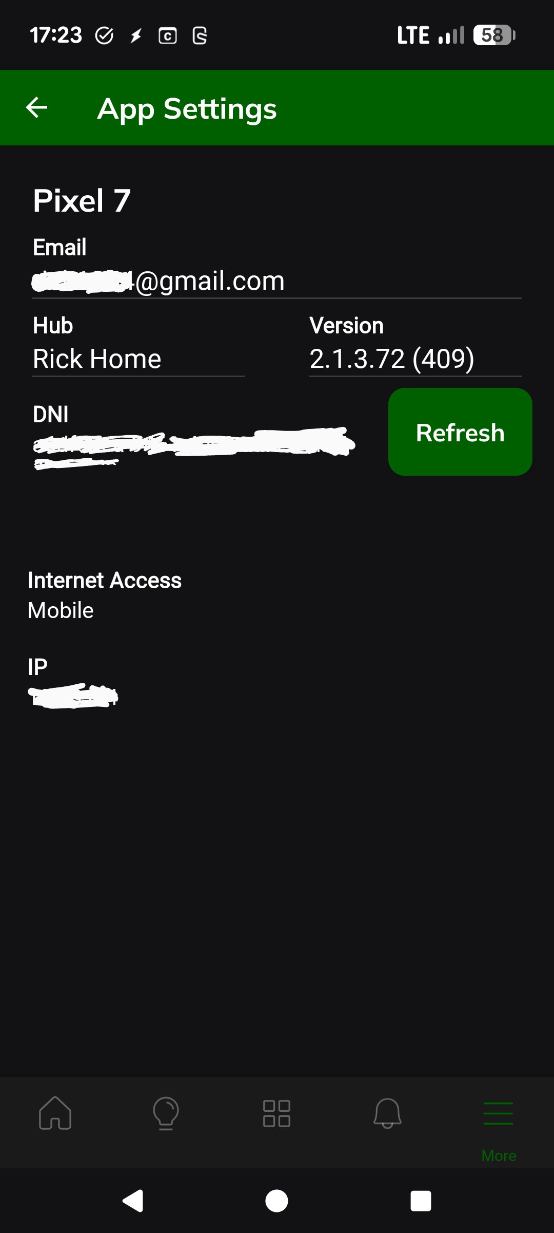

Under app settings, does it confirm that your Internet access has switched from "Wi-Fi" to "Mobile" and that your phone has obtained an IP address?
