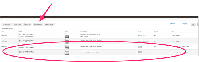

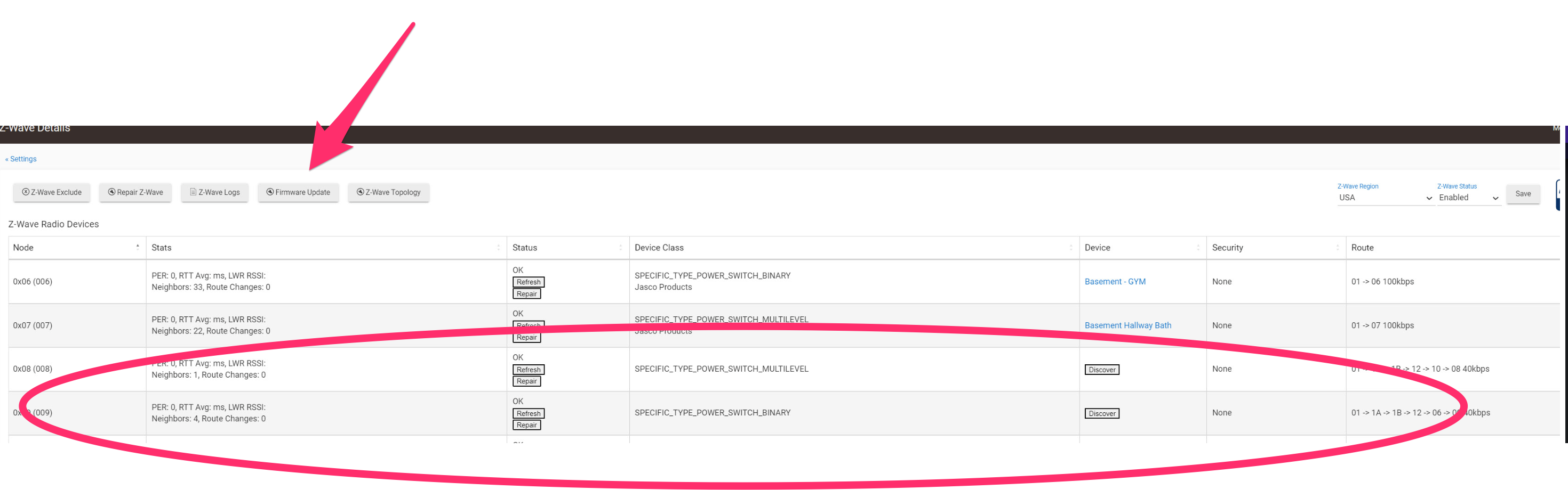

Here is a screenshot of my zwave page:
imgur(dot)com/a/Tw22jhB
Ok just to confirm you tried that zwave update from the zwave details page as shown? Not an update of the firmware of a zwave endpoint...?
Those two devices circled are a problem. If you look at the thread preceding you'll see how to get rid of them. I don't think your screen shot showed 55 devices so if you have more that look like those you'll need to address them too.
If you follow this link Hub owners - Hubitat and join the owners group you'll be able to post screen shots directly.
Yup, I am hitting the "Firmware upgrade" button that you pointed to. I have ten of these devices, how the heck do I isolate them out of all the switches that I have?
Yeah that is a challenge. I would like to get some assistance from support on the zwave firmware update failure though. One thing to try... open the zwave details page, let it sit there for 20 min, and try again. Opening that zwave details page causes a lot of zwave activity and sometimes with a busy mesh it needs to chillax for a bit before the update will work. If you can try again and let us know let's get past that issue first. Besides, if you can't successfully do a zwave firmware update, it may point to an underlying issue with the zwave radio that is the root cause of other problems. In that case we can ask BobbyD to take a deeper look but try my 20 min suggestion first if you would.

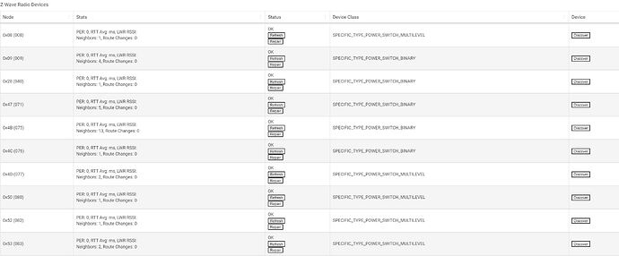

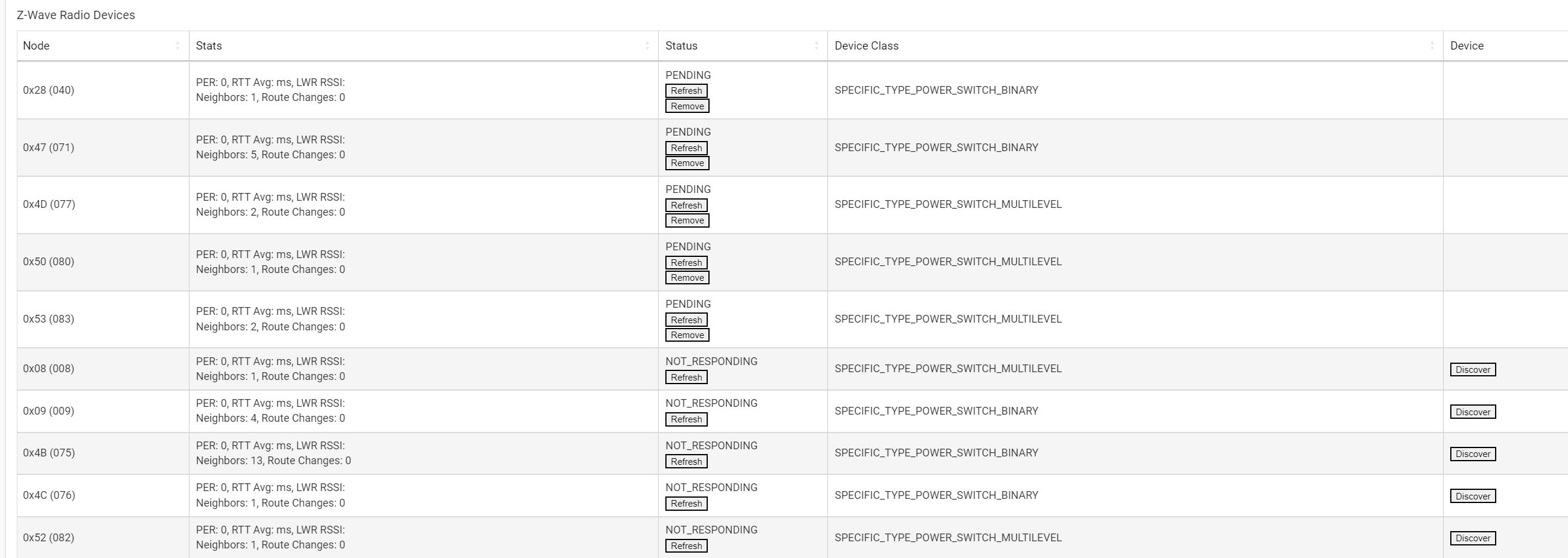

Staying on the repair page didn't do anything. Clicking on the repair button did the following.
Well that's a tad ugly I have to say.

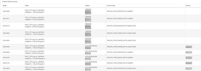

I logged in today to see how things looked and the bad/ghost devices are back. However I was able to upgrade the zwave firmware & my devices still work. Is there an easy way to remove them?
