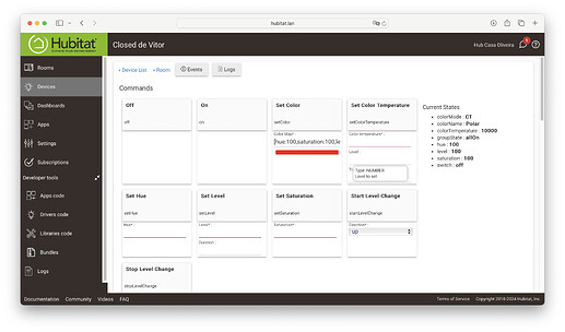

It's happening a lot I request to turn off some grouped devices, but the devices continues on, and Hubitat or HomeKit shows as Off.
(Look at groupStat allOn, even with switch showing as off)
