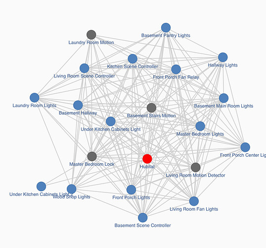

When it’s in the broken state is there anyway I can pay someone to log in and debug? I have no idea if these screenshots might be helpful.

Removing random devices might end up being a very time consuming task. What I usually do, is power cycle the device that fails the repair, then if that doesn't fix it, I would replace it. I would also check the routing on the Z-Wave Details page to see if the device is routing through another node, then check that node before taking action on a failed end node.
