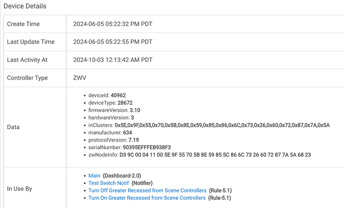

One thing ot note is when it doesn't work; none of physical switch action generate any logs in Habitat. As soon as initiate an action from Hubitat, all switches logging and rules would all work.
Note in this screenshot, the Last Activity still shows from couple days ago. But have been using the physical switches every day.

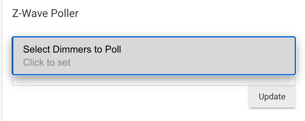

I tried the z-wave poller; but it doesn't show any devices. Keep an empty one running; doesn't seems to have helped either.

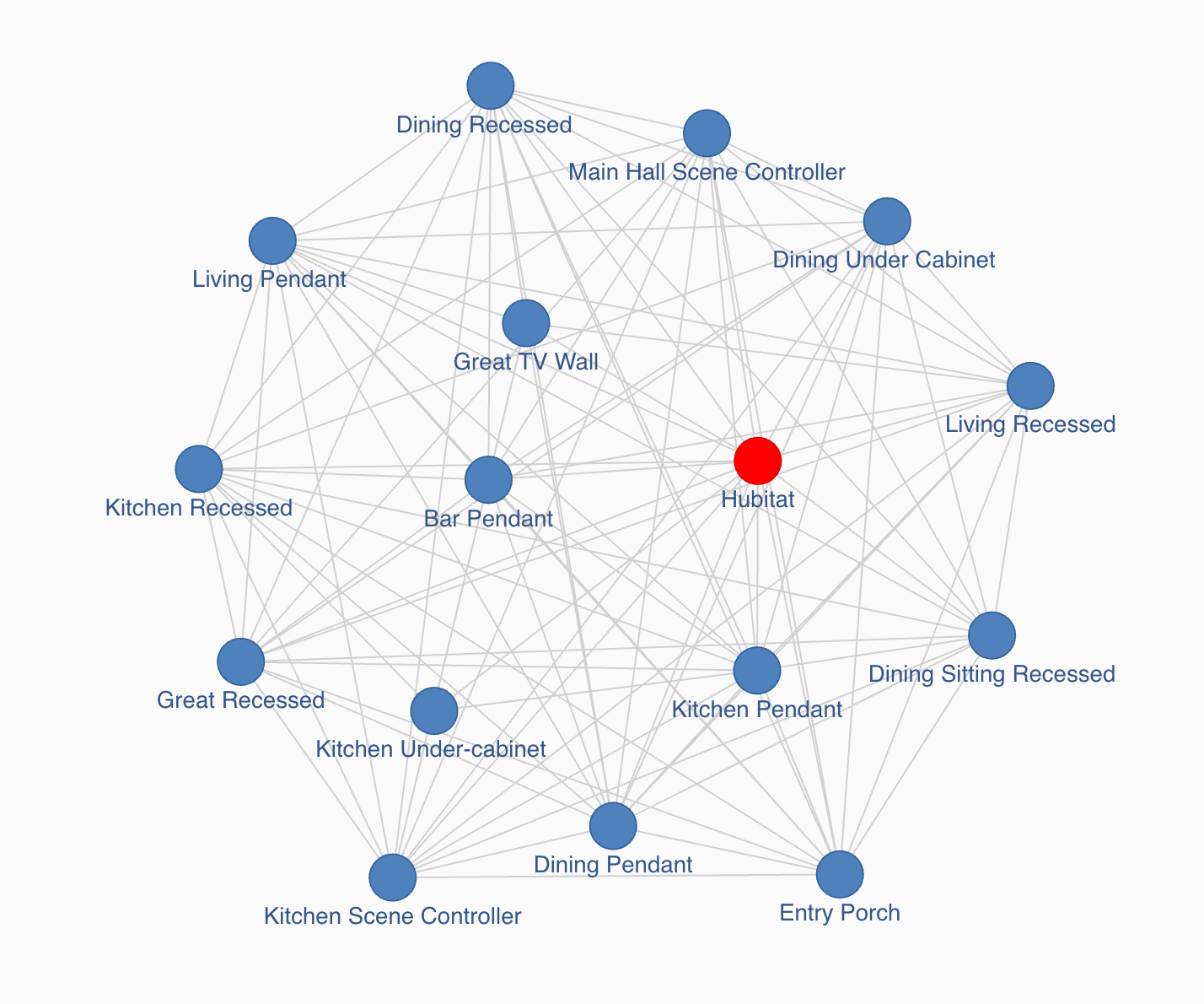

Here's what my network looks like:

To me, sounds like z-wave radio is getting clogged up, for whatever reason.
