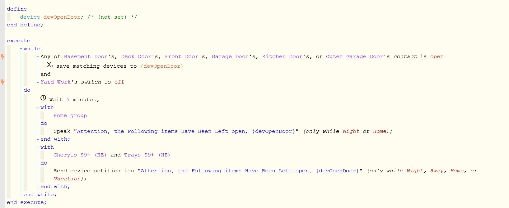

This is one area where I feel like Webcore might be the way to go. I have it check all the devices and save a list in a variable, and then send one notification with the entire list. (Unless someone can tell me a way to build a list in RM that does this as efficiently)

I am curious to know if webcore is faster than RM, although in this case I am not sure how I would compare times that are under a second. I do notice that you have a wait 5 minutes in your webcore post above. If you remove the wait condition how long would it take before your system speaks out the windows that are open?
