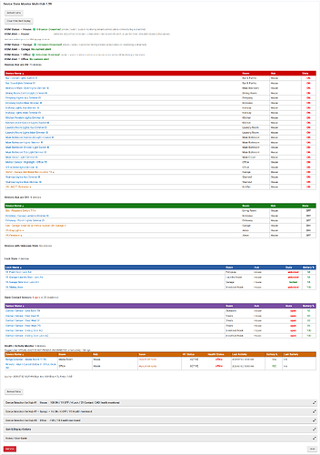

2026-07-02 - v. 1.59: Now provides 6 live tables:
  • ON Devices β€” switch-capable devices currently reporting ON
  • OFF Devices β€” switch-capable devices currently reporting OFF
  • Unknown State β€” switch-capable devices reporting neither ON nor OFF
  • Lock State β€” explicitly selected lock devices showing their current lock state (locked/unlocked) and battery level
  • Contact Sensors β€” explicitly selected contact sensors; by default only sensors currently open are listed ("N open of M monitored"), with an option to show every selected sensor and its state
  • Health / Activity Monitor β€” any device (switch or otherwise) that is OFFLINE, INACTIVE, NOT PRESENT, DISCONNECTED, or whose last activity exceeds a configurable time threshold
Above the tables, a Hubitat Safety Monitor (HSM) status badge shows the current intrusion arm state and any active alert. The alert display is verified against the hub itself on every Refresh (not just driven by events), and HSM on Hubs #2 and #3 can optionally be shown as well.
Device names are clickable links to their hub's device edit page. When Maker API credentials are configured, the State cell in the ON and OFF tables is clickable to toggle the device without leaving the page.
This is beta software (and likely always will be).
Example output:
