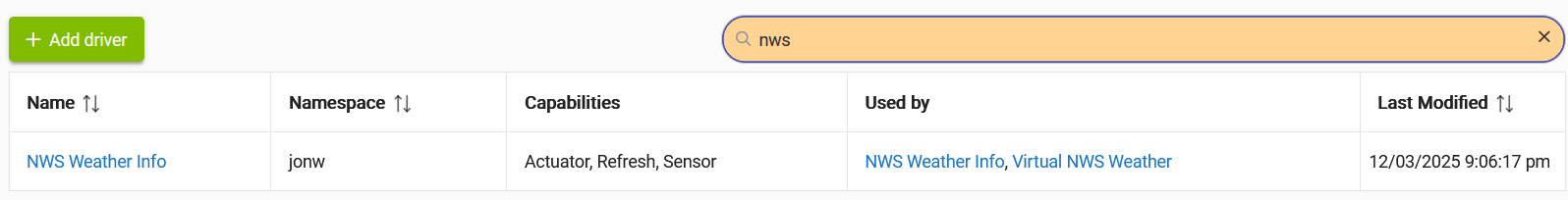

I added the NSW Weather app code to Hubitat: (NWS Weather Information Driver):
I then created a Hubitat device but the device never shows up in the auth list when I try to authorize it from SharpTools. I see the device in HE but not in the auth list:

Your device driver needs at least one attribute that SharpTools understands. Go into the groovy code and add [capability "Actuator"] like this:
metadata{
	definition( name: "the devicename: "theNamepace", author: "theAuthor") {
