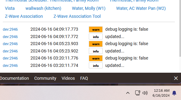

log shows actions occurred about 4 hours in the future. I verified the Hub and the browser time match.
Normally I see this when the latitude and longitude are incorrect
Is your browser in a different timezone?
Never mind, I missed this: I verified the Hub and the browser time match.
I found the culprit. It seems the LibreWolf browser has an issue with "reading" the times from the Hubitat page. Same event logs with Opera is fine.
