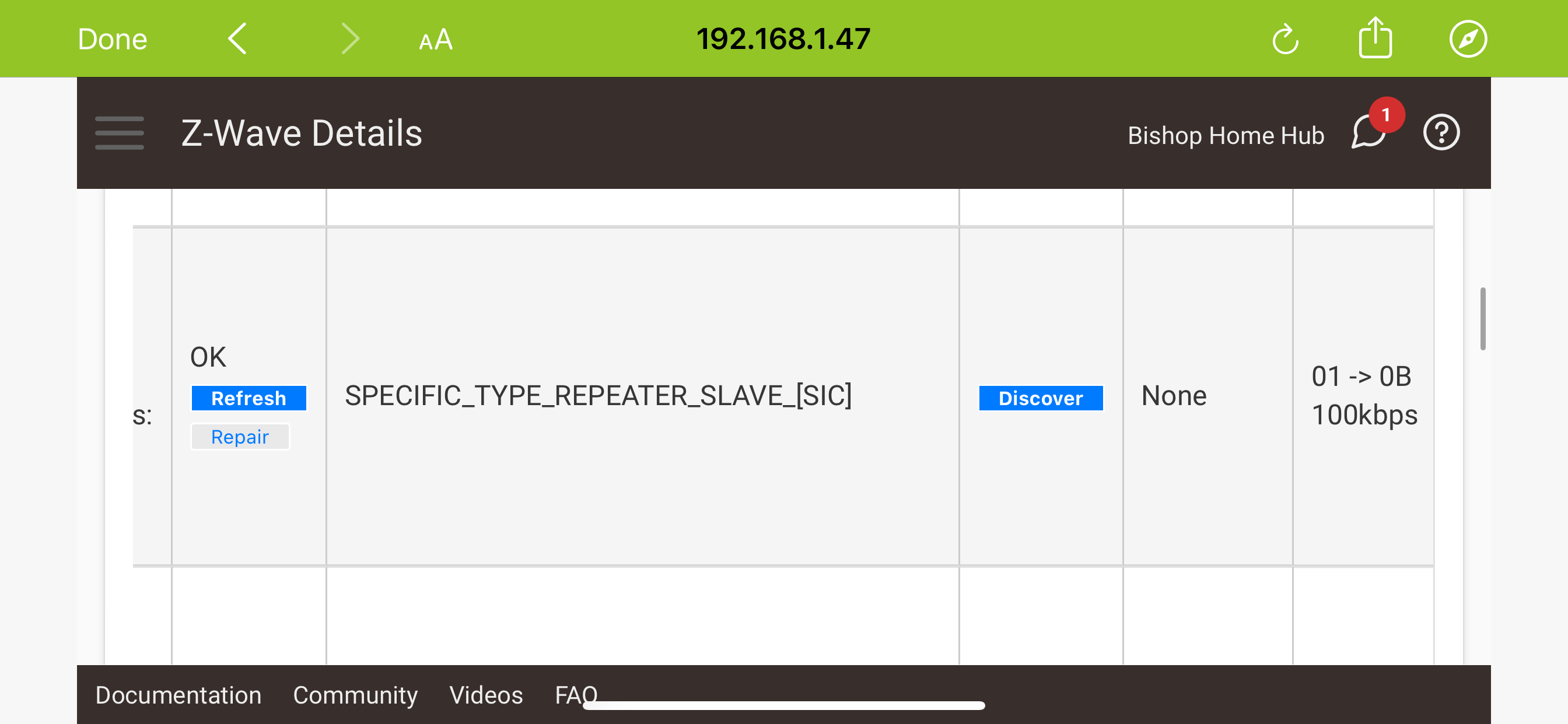

Is it possible for a z-wave repeater to be listed under Z-wave Details, but not listed under all Devices?
Not normally. If you click on the device name in the zwave details does it take you to a device page?
If is tied to a device it would be listed in the z-wave details, what does it say in the device column?
Yes it is possible, if after it was paired you then force removed the "device" it would leave the node behind, still working on the mesh but with no way to get info from it.
The device (aeotec repeater) is found only under z-wave details, and in the column that should list the device name it only says “Discover”, but the device is not found under the all inclusive Devices list.
Is this a ghost? How do I correct it?
Exclude / Remove it and pair it again.
Just tapping Discover corrected the problem.
Thank you, everyone!
