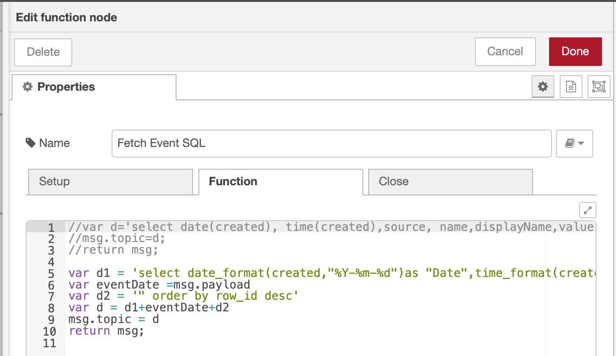

8. Fetch event SQL - function node to build the SQL to get all events for the selected date
Javascript to build the SQL statement for getting events
//var d='select date(created), time(created),source, name,displayName,value, deviceId,unit from EVENTS where date(created)=current_date() order by row_id desc'
//msg.topic=d;
//return msg;
var d1 = 'select date_format(created,"%Y-%m-%d")as "Date",time_format(created,"%h %i %s %p") as "Time",source as "Source",name as "Event", displayName as "Device", value as "Value" from EVENTS where date(created) = "';
var eventDate =msg.payload
var d2 = '" order by row_id desc'
var d = d1+eventDate+d2
msg.topic = d
return msg;
