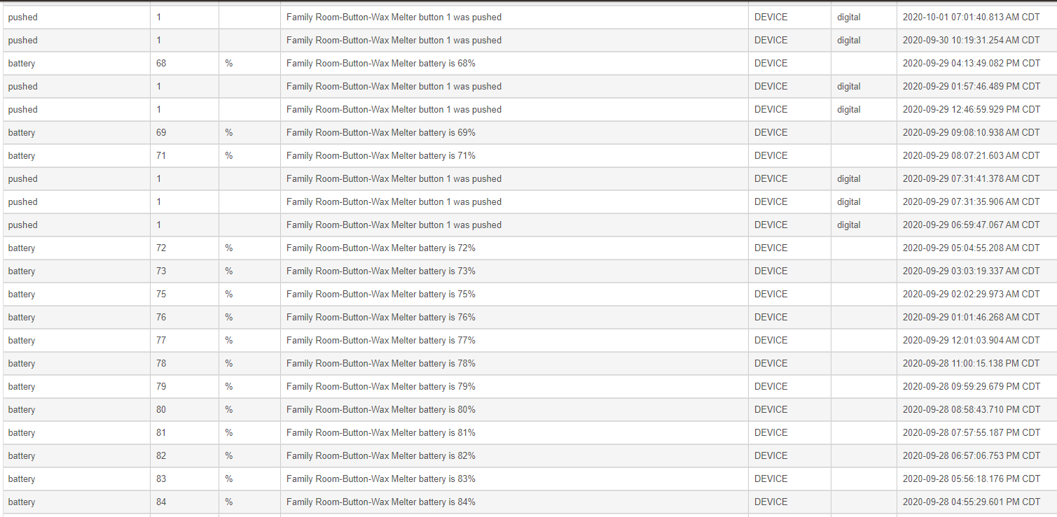

Here is one where I saw the draw down on the battery really quick. And it only seemed to report on large battery changes:
Lithium Ion batteries have a steep drop off. They report basically the same throughout their lifecycle and drop off steep at the end. Alkaline batteries typically report better because their falloff is pretty consistent. Not all, but most devices battery reporting capabilities are calibrated for the Alkaline curve.
Whenever I replace batteries in my devices I go into the device properties and click the Configure then Refresh buttons to get it to update the battery % and other info like Temp, Humidity, State to verify it is communicating again. Re joining the device after the battery was replaced should have updated the battery % as it should have affectively performed the Configure step as well.
