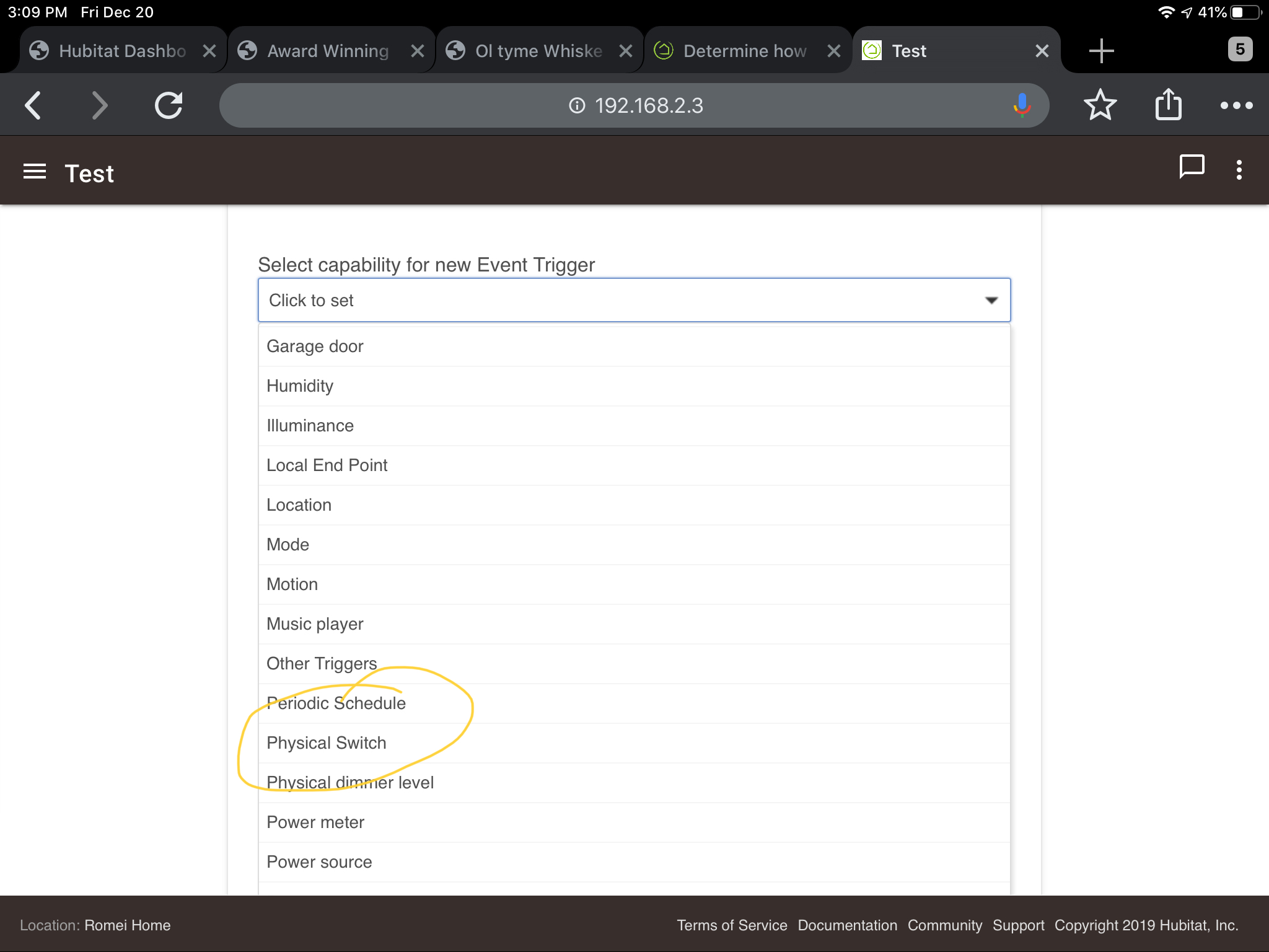

Seeing that the switch was turned on/off physically, is easy, trigger off of physical switch. Setting the Ge motion to ignore motion(occupancy) I do not see supported, even by custom actions.

How do I trigger off just the physical switch. Won't the same "off" event be called if the switches built in motion sensor turns it off?
