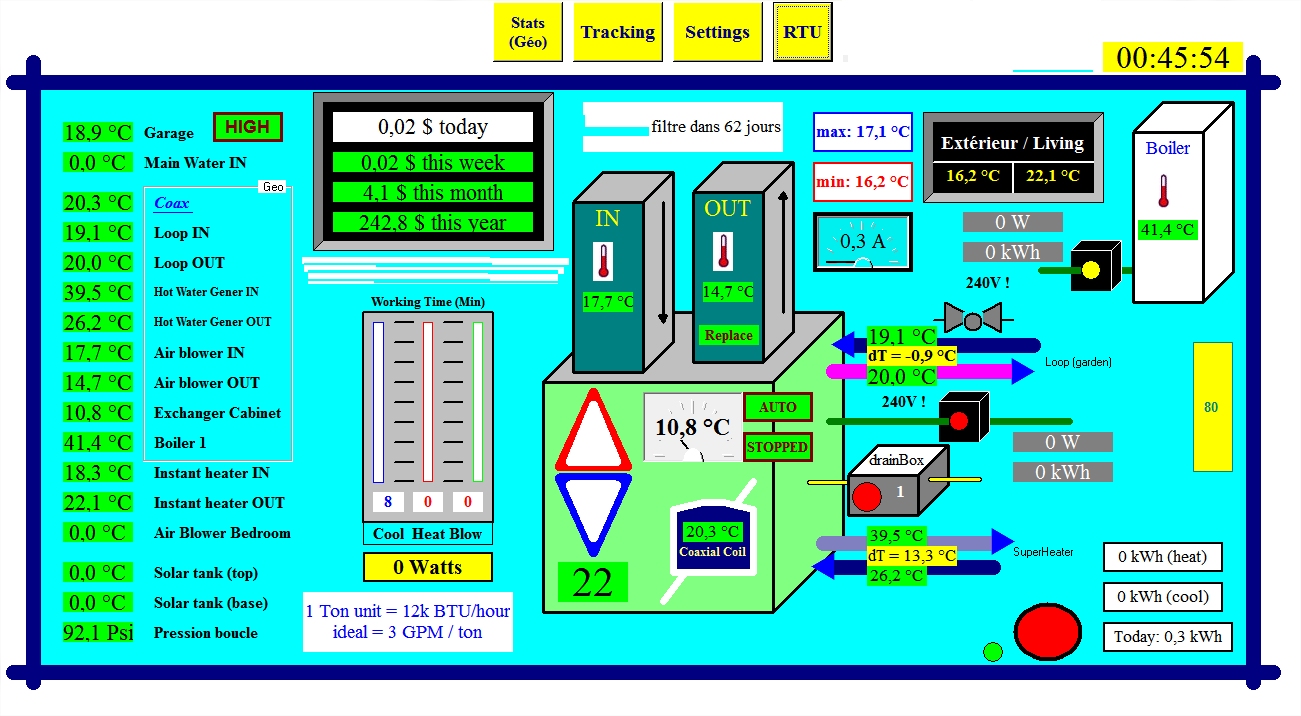

I can manage the way my geothermal unit works by only measuring 2 parameters: temperature and Amps.
To keep my explanation simple:
Current < 1 A: stand-by
2A < Current < 3A : blowing (fan only)
Current > 10A : running (fan + exchanger)
I measure the dT to see if my unit is cooling or heating. Some programming and Voilà !
And measuring the current can show you more indirect events. If the blower is nearly defective, the amps increases dramatically. If the filter is to be replaced (dirty), the amps of the blower increases too (the fan must run harder to blow the air through the filter), etc. Plus quantify the money spent on heating/cooling.
So keep searching the right power monitor, worth the purchase and independant of external events (external vibrations, noise around). Aeotec ? Qubino ?
For the pic, I know it's ugly. I'm colorblind and I work with plc with very tiny amount of memory...
Mike
