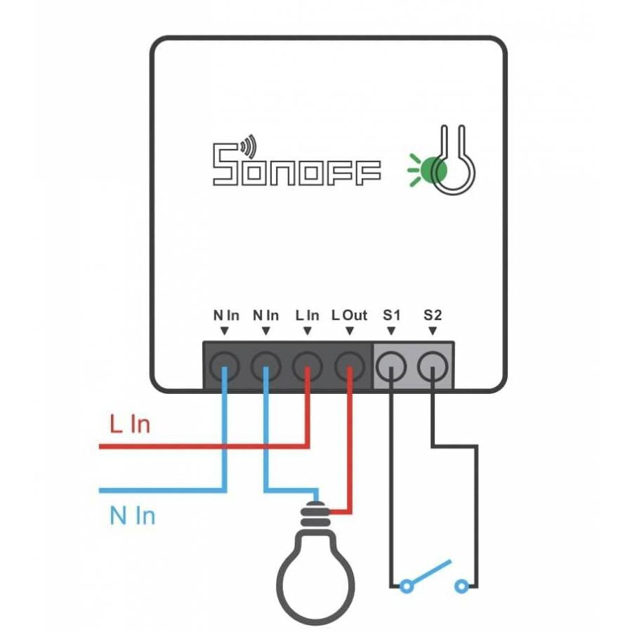

That isn't how those smart relays work. The old light switch would just tell them to turn on, basically a dumb button. The old switch doesn't cut power to the smart relay, so there should be virtually no lag.

Sonoff ZBMINI Relay will work if your ZigBee mesh reaches your garage.
