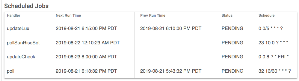

One other area for exploration is the Scheduled Jobs. There should be 4 of them with cron style schedules:
The schedule numbers for poll and updateLux will have /number where the number is the interval you've selected:
I suspect you don't have a pollSunRiseSet. Clicking Save Preferences will cure that.

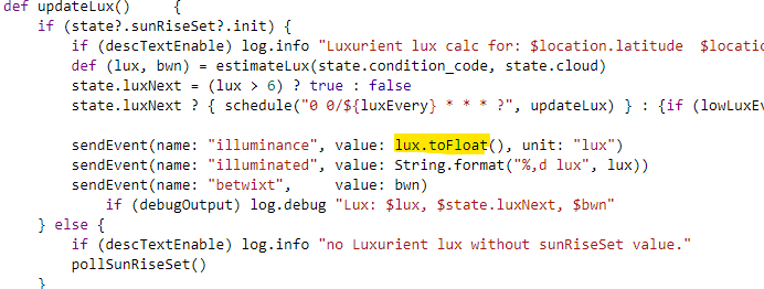

The Luxuriant-Driver seems to still be using a float instead of an Integer on the newest version:
hmmm.. well that's another error
Fixed, thanks.
