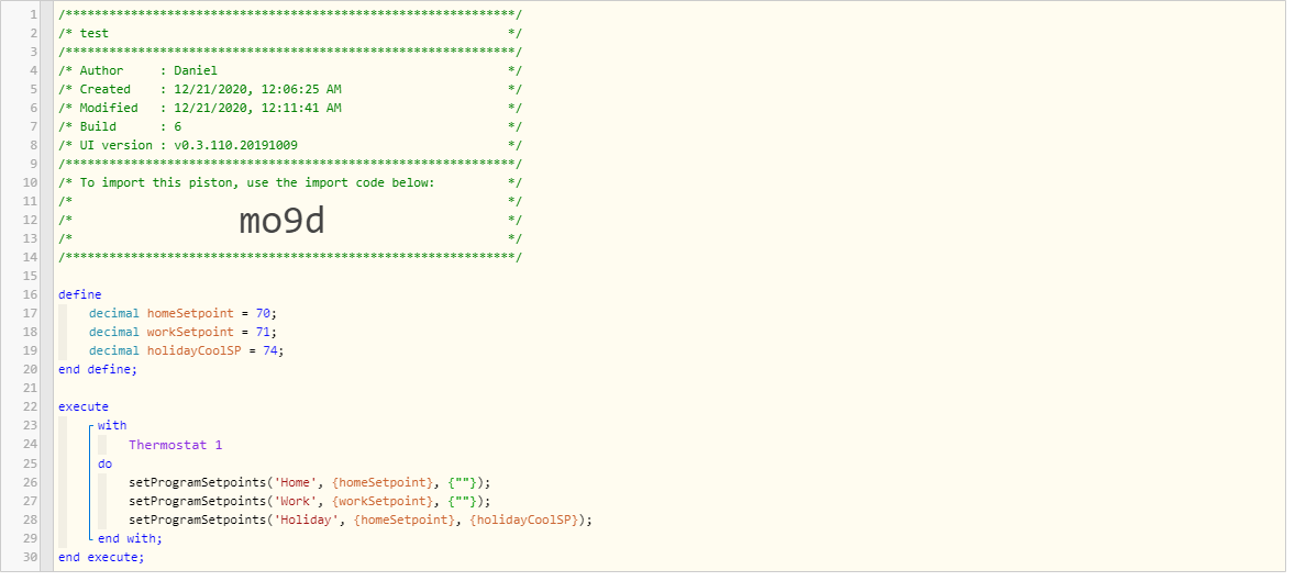

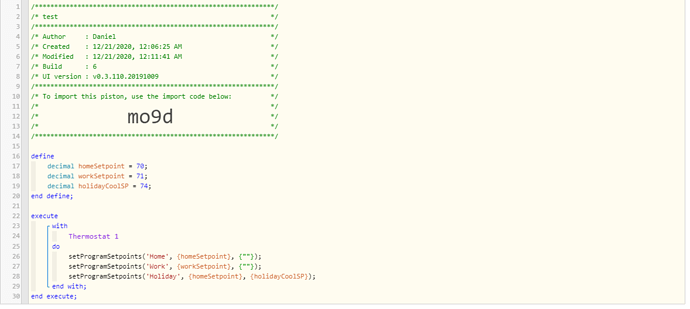

I'm running into issues with multiple calls to setProgramSetpoints(). When I run the following test piston:
Only the results of the final call to setProgramSetpoints() persist; the others all go back to their old values. If I keep the Ecobee app open to the Comfort Settings page and watch it while I run the test, I do see the other program values change to what I expect, but then I see them change back to their previous values a couple of seconds later.
I confirmed this by playing with the order of the setProgramSetpoints() calls. It's consistent -- the last one works as expected; the others revert a couple of seconds later.
You must,wait,for the poll cycle to complete before calling setProgramSetpoints() again. This because the method has to modify the in-memory map for schedules, then send the modified map. It can’t change the map again until the server acknowledges the previous change (by updating the map). If your polling frequency is 1 minute, delay 150 seconds between calls; if it is 3 minutes, delay 390 seconds 92x frequency + 30 seconds).
Two questions:
  1. Is it possible to make the function able to support modifying multiple schedules at the same time? Maybe a varargs version that takes a repeating triple of (programName, heatingSetpoint, coolingSetpoint)?
  2. If not, is this something the app can handle automatically? (Queue up multiple calls that happen within the poll period.)
And a third question, as a last resort:
  1. If nothing else can be done, can you at least expose the poll period as an attribute on the thermostat object so that I can access it from webcore?
All good questions, but the easiest solution is for you to do what I do in the Smart Modes helper when it needs to change the setpoints. Basically, you wait for the climatesChanged attribute to be updated with a new date/time before you do another setpoint change.
FWIW ( and IMHO), changing program setpoints shouldn't really be a frequent thing - it is MUCH more workable to just have different programs for different setpoints. I myself use this approach to select different sets of remote sensors depending on the time of day, for example.
It's for a "keep the wife happy" use case. Depending on the outdoor temperature, the heating set points of certain programs need to be adjusted by 1 degree. The programs themselves are scheduled at the thermostat, and the schedule doesn't need to change.
Welp, if you insist. Two solutions:
  1. Change the CURRENT program's setpoints first, wait a few minutes, then do the next one...
  2. Change the CURRENT program's setpoints, wait for climatesChanged to be updated, then change the next one...
I can't implement multiple changes within the device itself, because called methods must return to the caller within the calling context, but it can take minutes before the in-memory maps are updated by the Ecobee Cloud. I have no choice but to modify, wait, modify...
Ecobee Suite Updated January 4, 2021 at 3:10pm EST
Enhancements & Fixes:
  • Ecobee Suite Manager, version 1.8.51
    • Fix Debug Dashboard error
    • Allow changing multiple programs' setpoints all together in setProgramSetpoints() (see ES Thermostat for API explanation)
  • Ecobee Suite Thermostat, version 1.8.20
    • New function call: setThermostatHoldHours(Integer hours) allows you to programmatically change the hourly hold duration (e.g., via WebCore or HE's Rule Machine)
    • Expanded function call: setProgramSetpoints(String Program_Name, Number heatSetpoint, Number coolSetpoint, Program_Name_2, heatSetpoint_2, coolSetpoint_2, ...)
  • Ecobee Suite Sensor, version 1.8.08
    • Changed the devices' definition metadata to show the current Temperature instead of Motion in the new Samsung SmartThings App.
      • Note: this change was provided by a user of Ecobee Suite. My understanding is that the new display won't be shown immediately - the app's cache must be reloaded on the mobile device before this change "takes".
