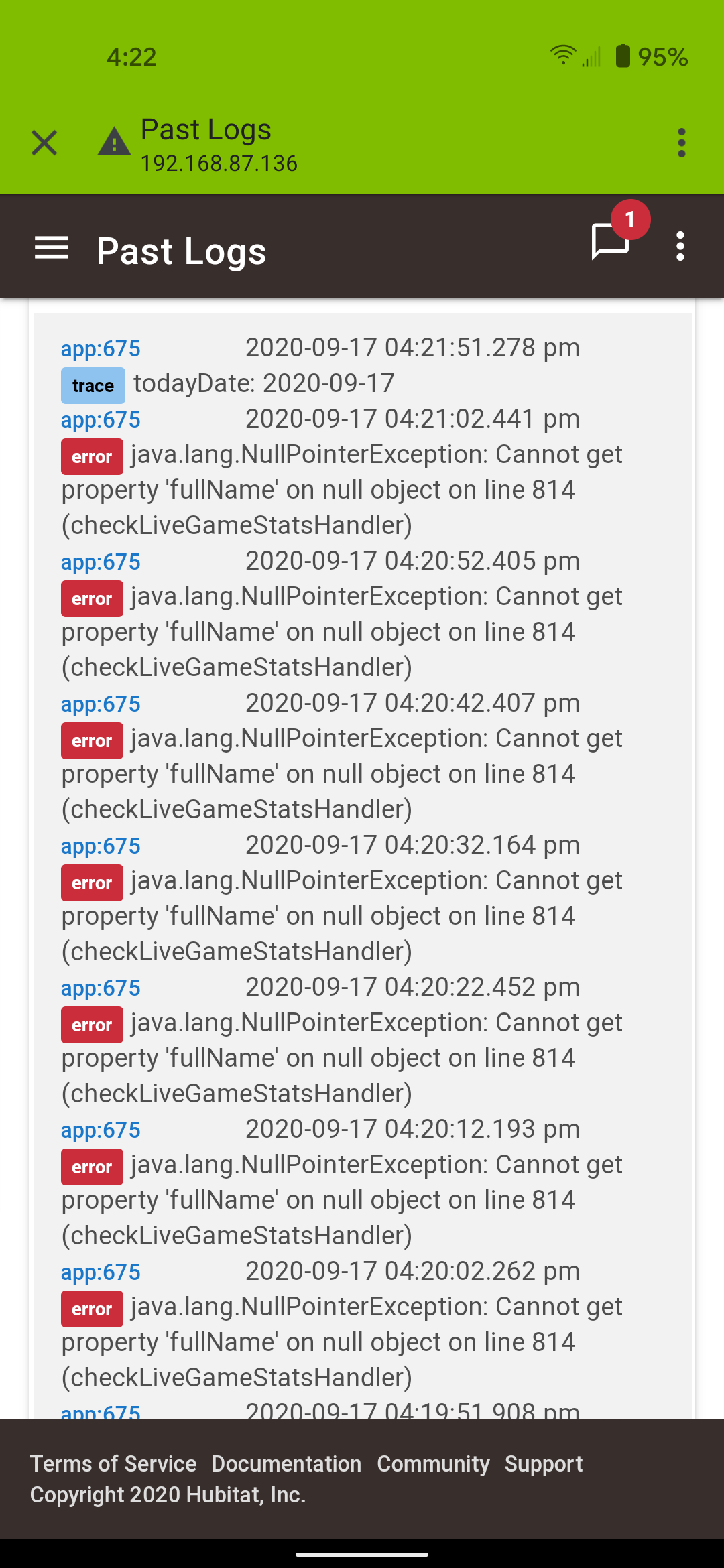

What an I doing wrong? Lol these are the errors I'm getting now. Everything in the scoreboard is updating correctly. In the settings I just have it turning in a switch with a win.

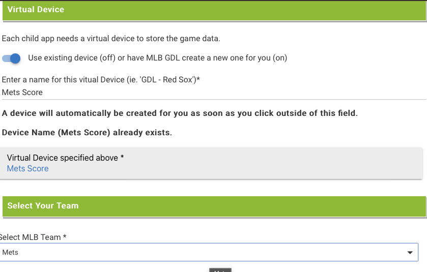

I've set up a GDL Child for the Mets Score - > Had it create the Virtual Device for my team:

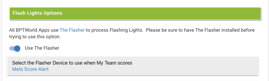

and setup up the notification options to flash on the Flasher created device:

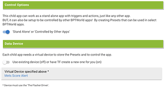

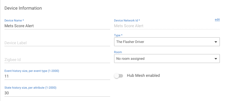

within that Flasher Child - I have allowed it to be "controlled by other apps", and had it create the Virtual Device "Mets Score Alert", to which I gave it the Flasher Driver:

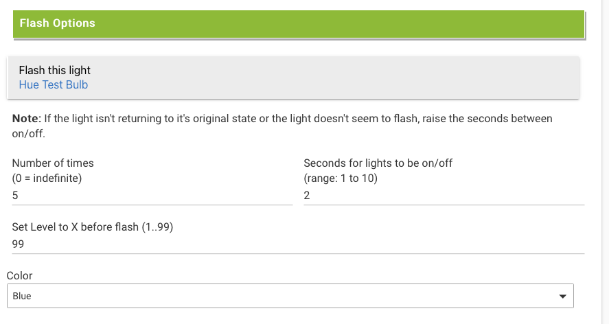

I set the Flashing options as listed below for a Hue Bulb that I verified works through habitat controls:

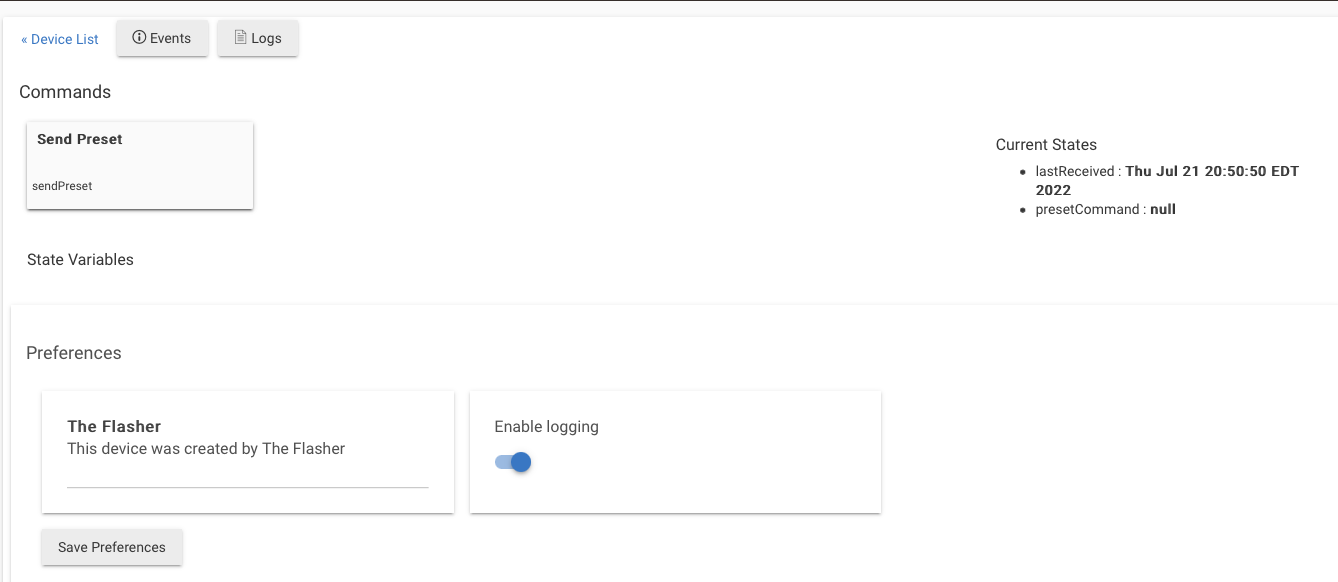

With all of that saved, and I go into the "Mets Score Alert" device, and try to send a test, I get presetCommand: null
there are zero logs to show for anything when I press the button... I've been at this for a few days now, and hopefully this info may bring someone around for some guidance. I love this idea, and would love to use and share if it's still working!!

This code was a port from ST. It never worked quite right. Which is why it has a code freeze. I do plan to go back to it at some point but probably not anytime soon.
