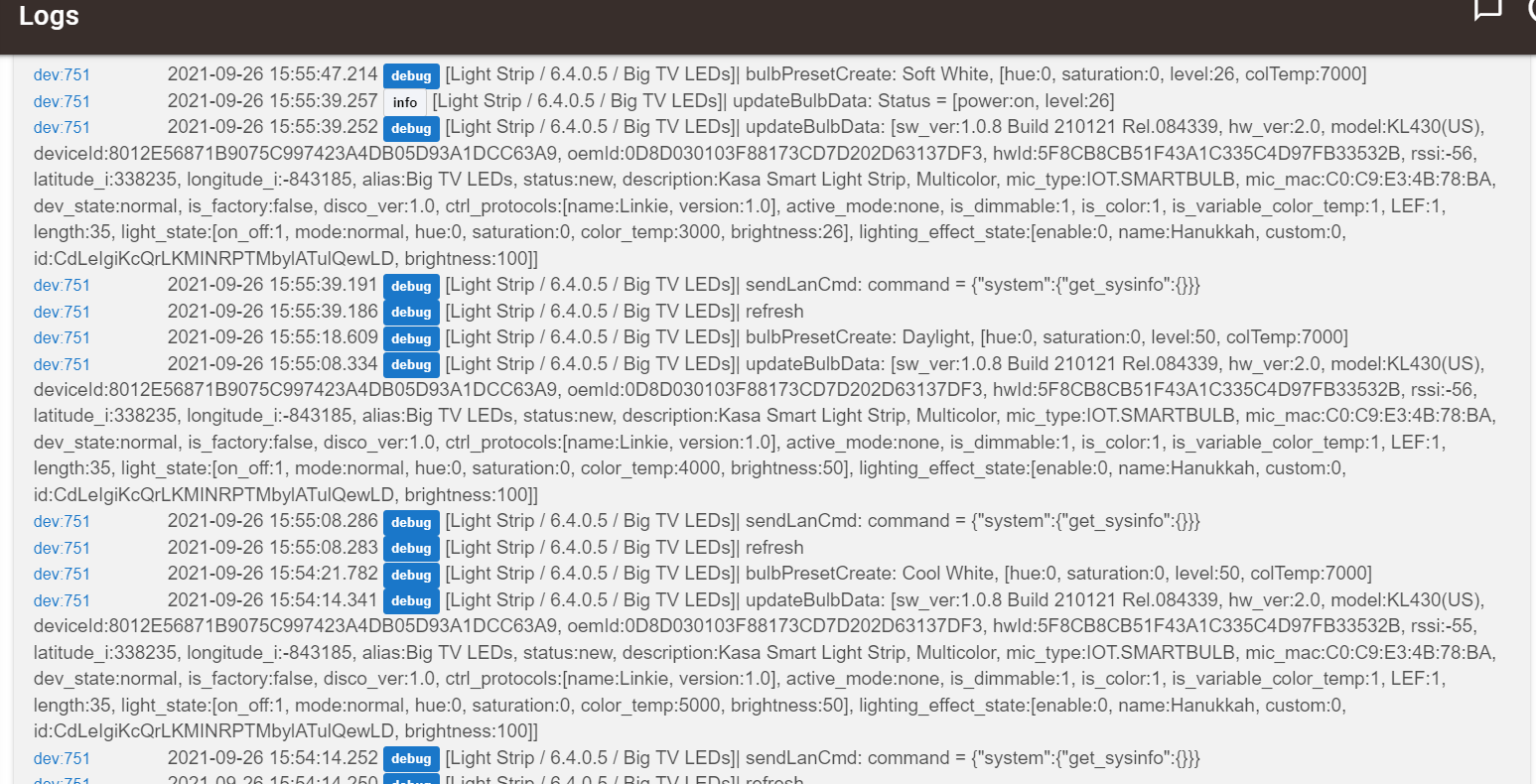

Alright, I swapped all the KL430's over to the Light Strip driver and reran the app. Having trouble creating the preset for the same reason we had before. No matter what CT setting I select in the Kasa App and refresh in HE, the device screen only reads a CT of 2200. So all it's capturing in the preset is the Level.
When I use the Alexa definition of warm white I get the red color, so I can't copy that as a preset.
Do I need to provide logs of this? Am I missing a step?

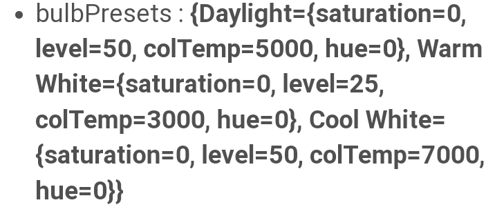

Tested Bulb Presets for CT and for Color bulbs. Below is a list of tested presets:
  • bulbPresets : {Red={saturation=100, level=100, colTemp=0, hue=96}, 5000={saturation=0, level=50, colTemp=5000, hue=0}, Blue={saturation=89, level=79, colTemp=0, hue=64}, 2000={saturation=0, level=20, colTemp=2000, hue=0}, Orange={saturation=89, level=87, colTemp=0, hue=5}, 9000={saturation=0, level=90, colTemp=9000, hue=0}, Green={saturation=100, level=100, colTemp=0, hue=24}}

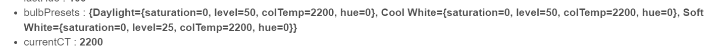

Are you SURE you are testing CT on a KL430? I just don't understand how we've fallen so far from the CTs as they were working under the bulb driver. Even going up and down the CT spectrum, it will never get as white as they are capable of going and if you enter a CT value of 8000-9000 it goes back in the other direction and gets warm white again. In the native kasa app, the app represents its CTs going up to 9k.
I am trying to create bulb presets. If I try to create the preset based on the CT defined in the table, I get those awful red colors.

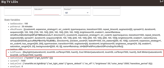

In the device page:
Set the bulb how I want it to preset. I'm doing this from Kasa native app because the CTs are so messed up that I can't enter the CT in HE.
Click refresh so it will grab the the config of the bulb, assign a name, and click create preset. It creates a preset based on whatever CT was in the app and just corresponds it to the color table that gives the bad colors.
You've mentioned multiple times that its supposed to be grabbing the Hue and saturation but I have yet to see these be anything other than zero.
They will remain ZERO if you are using the Set Color Temperature command (always zero). Use the Set Color command and see the results.
I just did a setColor with the values h= 2, S = 66, L = 55. Saved as "Red". The resultant state is : bulbPresets : {Red={saturation=66, level=55, colTemp=0, hue=2}}
Deleted a red and ran CT to 6000, level 88. Saved as "6000". The resultant state is : bulbPresets : {6000={saturation=0, level=88, colTemp=6000, hue=0}}

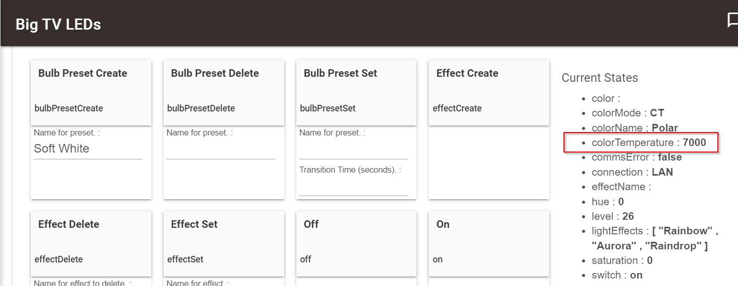

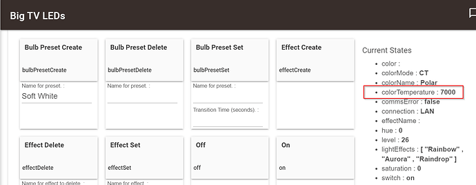

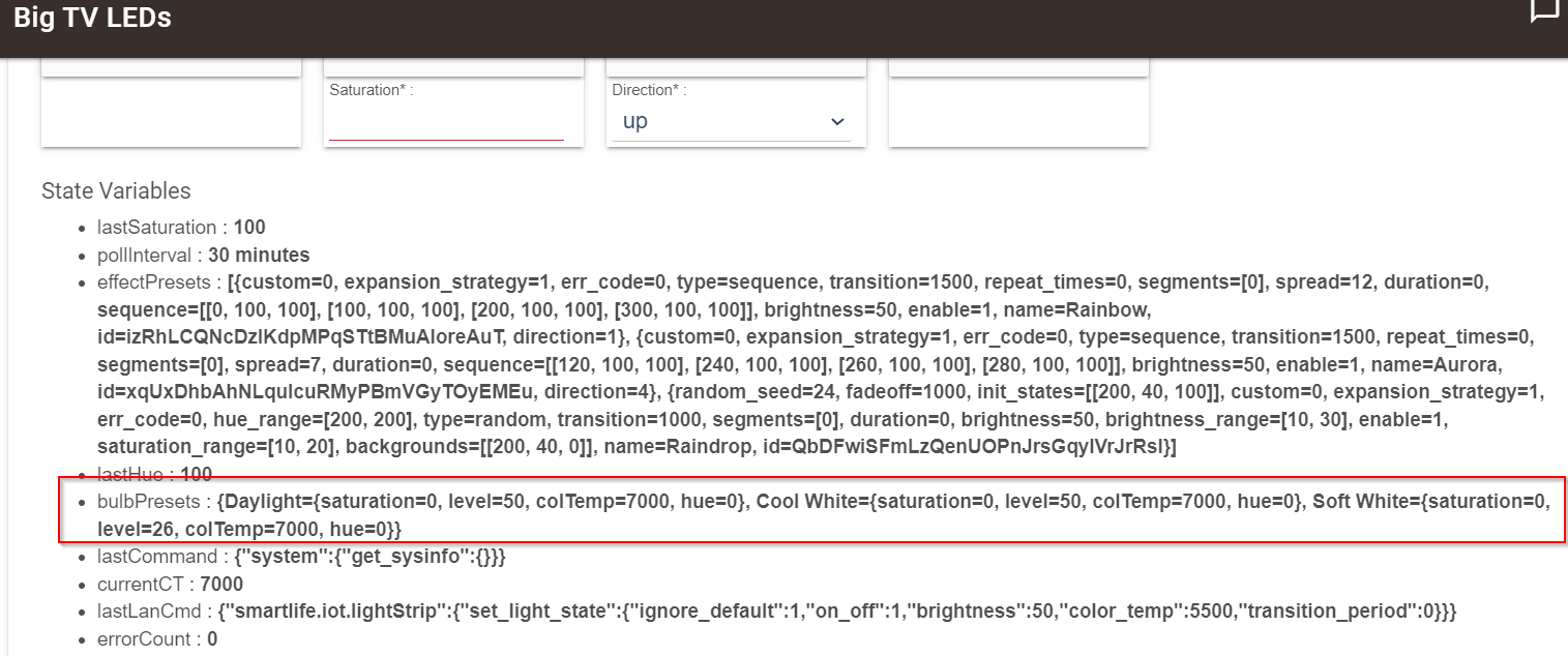

Thank you for that clarity. I was able to go through every one of these steps as as you described and I got the same results that you described. The difference is the resulting color. I played with several CT and this is what I observed:
Using a CT of 6000, yes when you look at it, looks pretty normal and appears to be doing what is intended. The preset saves fine.
As soon as you start deviating from 6000, that's when the bad stuff happens. 5000 CT is salmon, 4000 is red, 3000, is even redder. Going back in the other direction 7000 looks ok, but then when you push into 8000-9000 it starts getting warm again (which should continue getting cooler) and the bulbs are capable of getting cooler visually.
I think what this exercise has taught me is that the functionality of the preset is working correctly, its just the table needs work to where I can get any other usable CT out of it besides 6000.
I can deal with imperfection or just a few presets. If I can just get a stable soft white, daylight, cool white, thats all I need but I just can't make it look worth a darn with the new CTs. I was even willing to compensate for wacky CT (by offsetting them numerically) but I feel I cant even do that and make it work.
All that to say, I think the issue is the CT table. Oh and I DID a repair.
