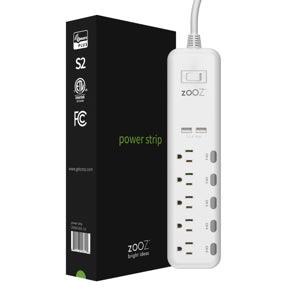

I was in market for a smart power strip, as opposed to a power strip loaded down with individual Zigbee plugs. Sadly, Kasa Wifi-based seems the only option that works with Hubitat these days. The only Zigbee/Zwave options are Tuya devices that lack compatibility with Hubitat, and are even possibly a fire hazard (looking at you Zau Zau).
I picked up a Kasa HS300 and dove into the integration today. I had to use the cloud option to detect my devices, with LAN detection failing. How reliable is this device if you experience an outside Internet outage or if Kasa were to shut down or deprecate cloud functionality for this power strip? Is it just a doorstop then, or one of those devices you can rely on even when disconnected from a proprietary cloud backend?
Really learning to hate these cloud backends, and I only grudgingly accept wifi devices, since they seem to be the only option in so many cases these days.
