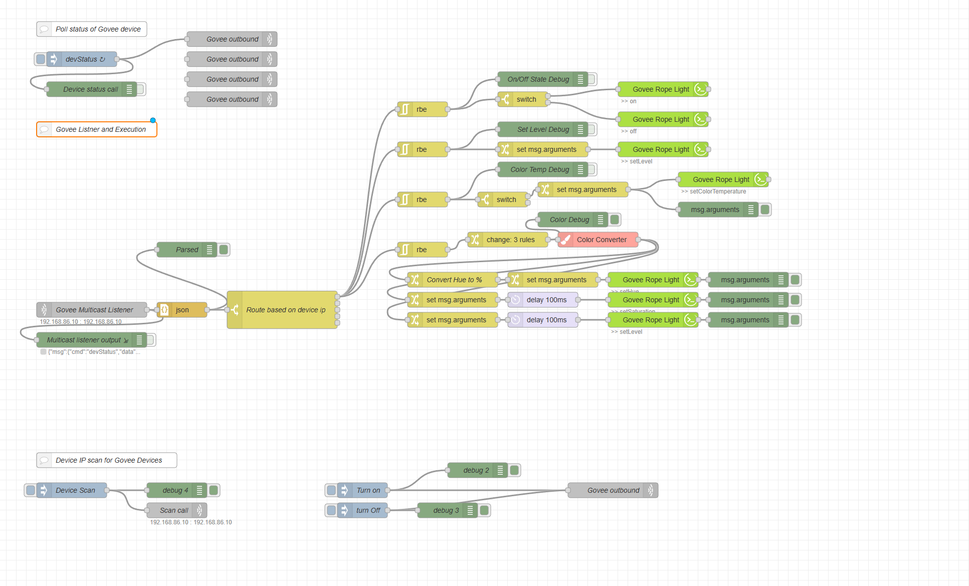

I am not sure if anyone is interested in using Node-Red to fully remove the cloud, but here is a flow to do just that. It is able to poll the device with the LAN API and then update Hubitat of the relevant local LAN API items without using the cloud. The only benefit to this is to removing polling from the cloud API and since this is all local it can be a very short interval like 5 seconds.
With this you could have it poll the device as frequently as you want.
In theory you can also then automate through Node-Red as well
Though the flow has allot of stuff only a few changes would be needed for this to work for anyone.
  1. Update your source IP for the "The device Ip Scan section" to reflect your Node-Red Servers IP address
  2. Create a Govee Outbound connection for each device you have that is detected in step 1
  3. Add a Switch in the "Rout based on device IP" node for each devices IP found in step 1.
  4. Copy the batch of nodes after the swtich and attach them to the new switch connection in the previous updated node
  5. Update the Hubitat command node to reflect the correct device for that IP.
  6. Lastly update the repeat interval in the "devStatus" node for the frequency you want to poll the device for status.
Once this is done it should allow you to make changes to the device with Govee home and have that update replicated to Hubitat fairly quickly.
I haven't had enough time to test if any impact is caused on Hubitat from this, but will post of there are any issue creeping up with it.
** I found a issue with using Node-Red to keep things in sync. Simply put as you change values certain other things don't change but are still passed ie color mode. This normally isn't a problem as long as the Flow doesn't get republished, but when it does all values are new and then potentially send unneeded updates to the devices in HE. One partial fix for this has been to adjust all of the updates to flow through a switch node that only sends updates if the switch value is 1(on). This only prevents the devices from turning on in the middle of the night if a color value was set. I would suggest possibly avoid keeping color in sync between HE and Govee over the lan APi. I am still experimenting with the flow.
