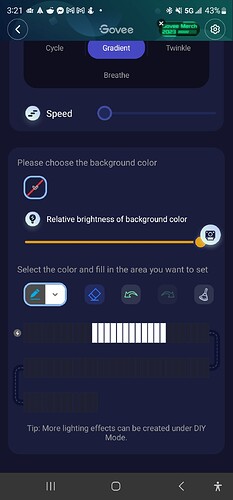

The snapshots are LED specific, that's why I used them instead of a DIY.
I have certain LEDs come on above my garage doors that open depending which open, instead of a whole string. Some section of my backyard. Very granular control of each individual LED.

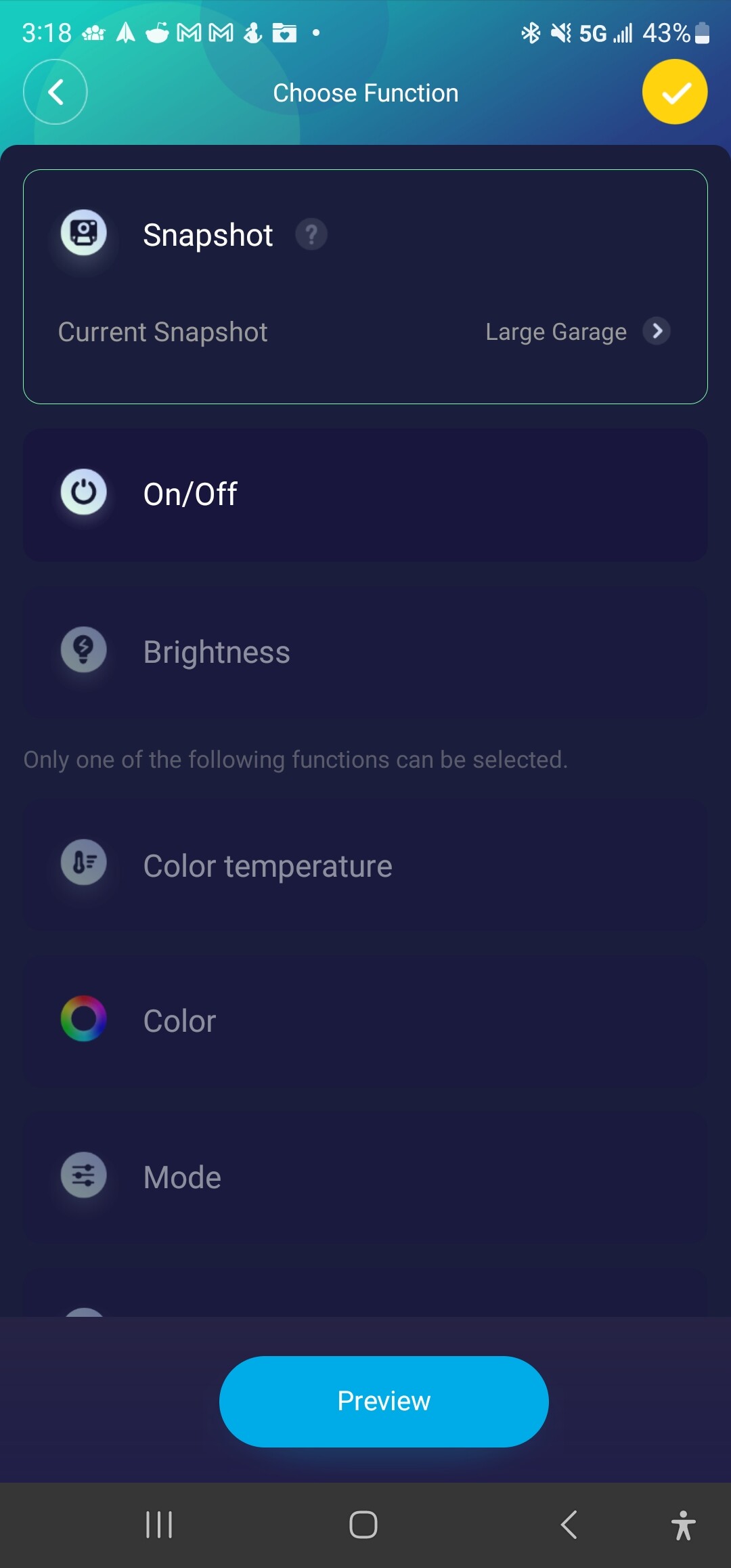

Then go into the Govee Home app and setup a tap to run with the Snapshot. Keep track of the group name you create it in .

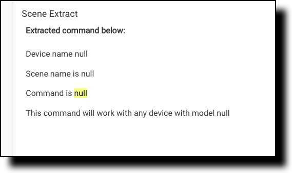

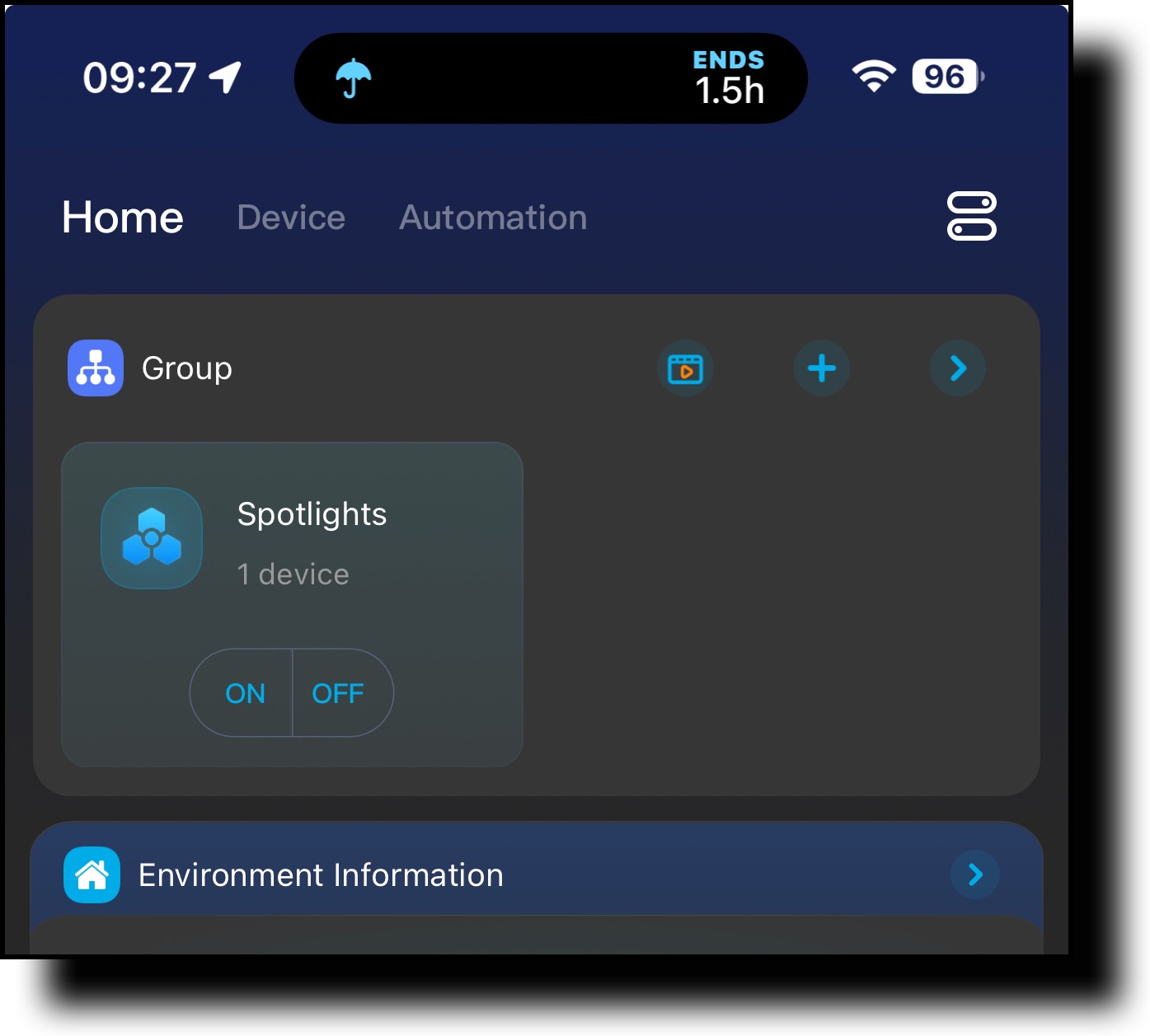

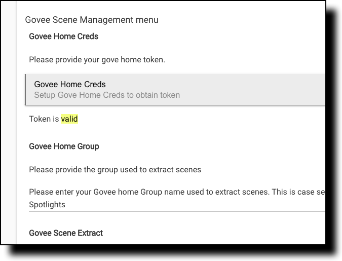

I can't seem to get the scenes to extract, and I think I'm doing things right. Any insight/guidance would be appreciated! Here's pics of my group, the LAN control/token showing as 'valid', and then the results of when I click to extract:
Based on your first screen shots It looks like you added the device to a device group instead of a "Tap To Run"
In the Govee Home app you can create groups of "Tap To Run" automations. That is what the second screen shot allows you to setup. That value is there so you can set a custom grouping to do the Scene extractions for Hubitat. By default it uses Default which is the name of the standard group in the Govee Home Android App.
I would suggest you go into the Govee Home app and scroll down. You should see a section for Tap-To-Run that is probably labled default if you don't already use it. Add a tap to run with the device and scene you want. and save it. Once that is done go back into the Govee Integration app and set that "Govee Home Group" value to "Default". Click done to save it and then run the extraction process again. It should work once that is done.
Sorry for the terminology confusion.

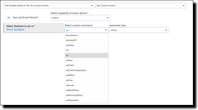

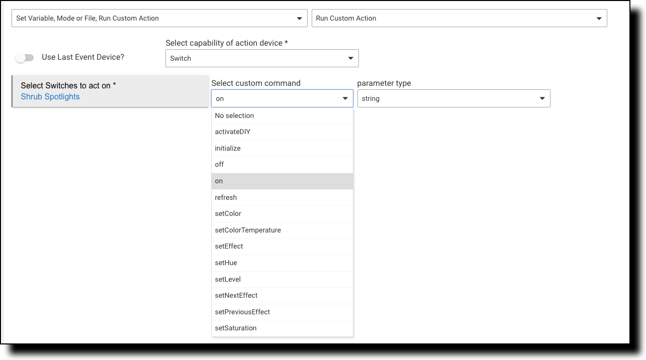

Thanks! That worked! To set the scene that was extracted, do I do something like this in RM:
Run Custom Action > (device) Switch > (custom command) setEffect > String
(...I had clicked on 'on', which is why it's highlighted below...)
Or is there some other way I should be setting the scene?
Yea that looks right. Just make sure you select setEffect and pass the Number for the scene you want.

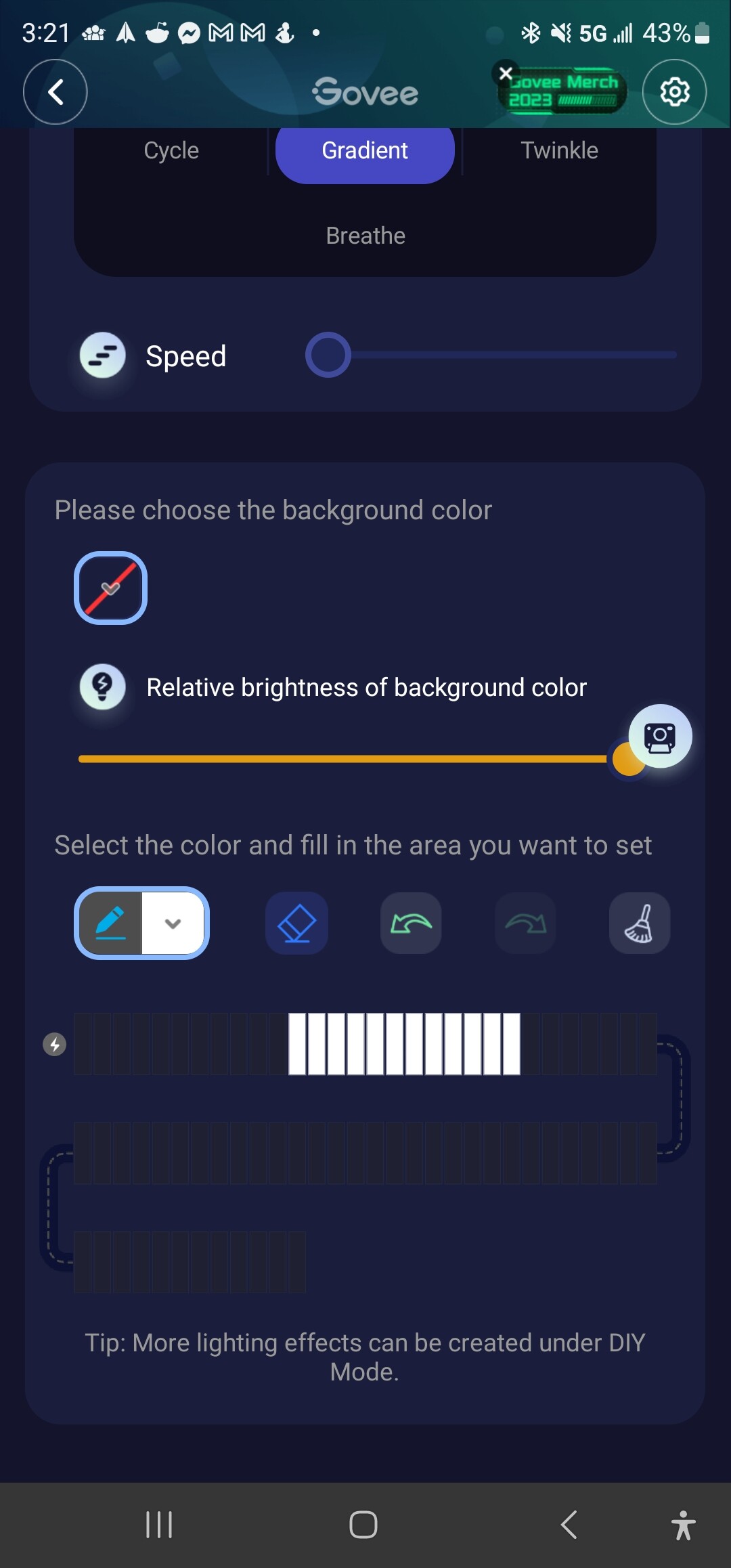

I think i realize what you mean by LED Specific. I will think about this and get back with you. Would it be ok if it only captured the led colors chosen and you still needed to set brightness?
Snapshots can involve multiple commands unlike scenes. So they are potentiallya more complicated idea to capture. If you can take care of something like setting brightness then we can capture the command for the individual led's as a single command.

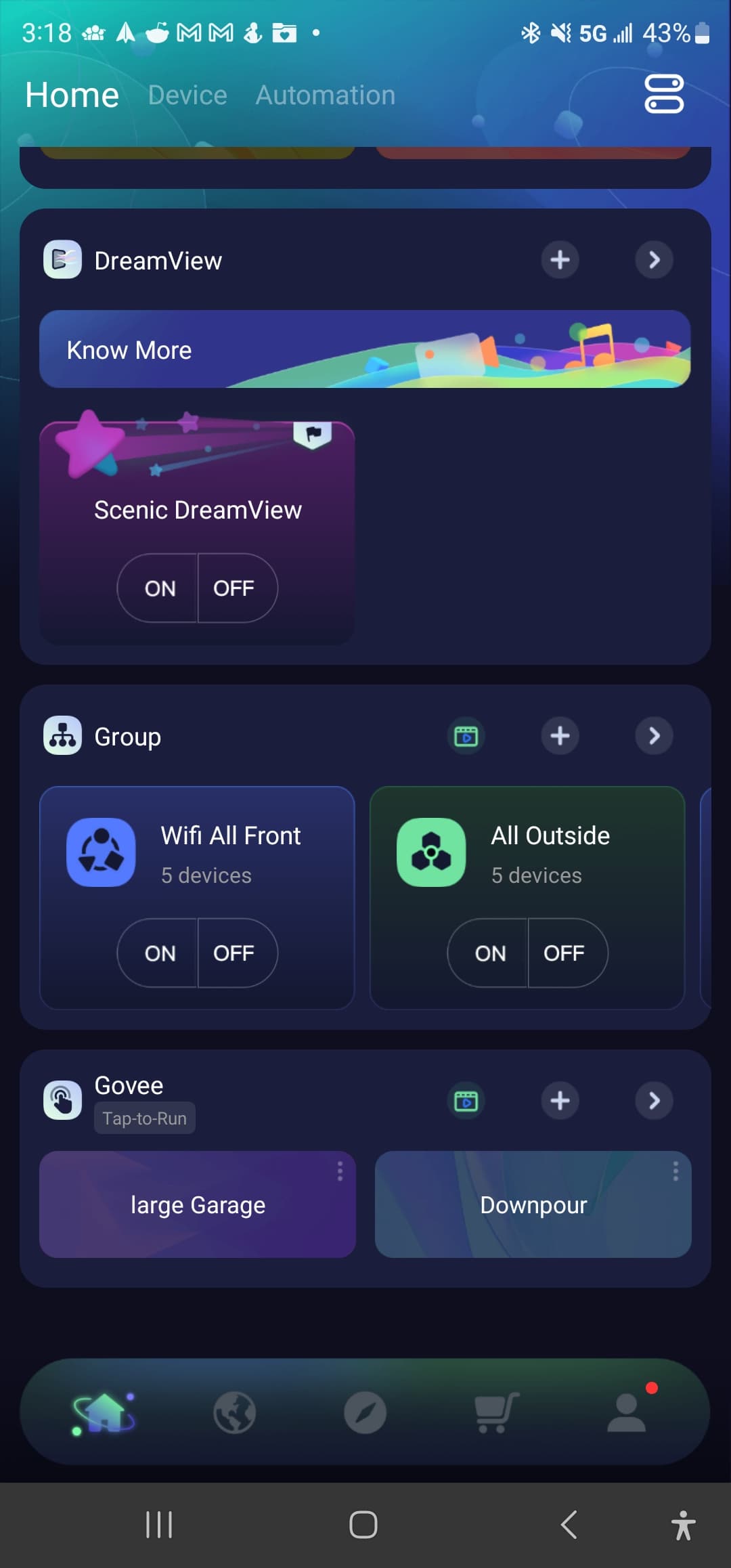

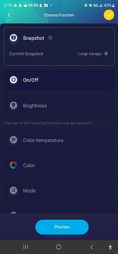

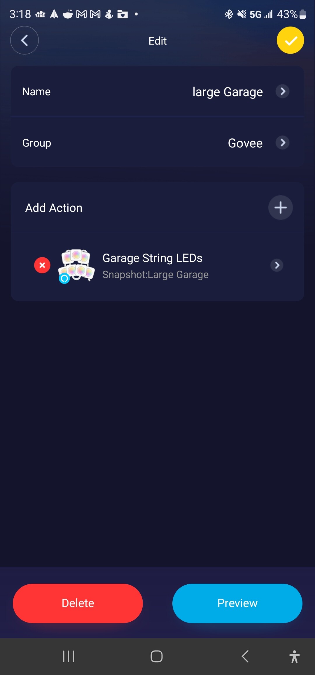

Can you show me a screenshot of your tap to run with the snapshot?
