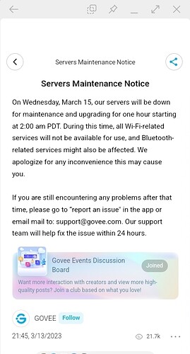

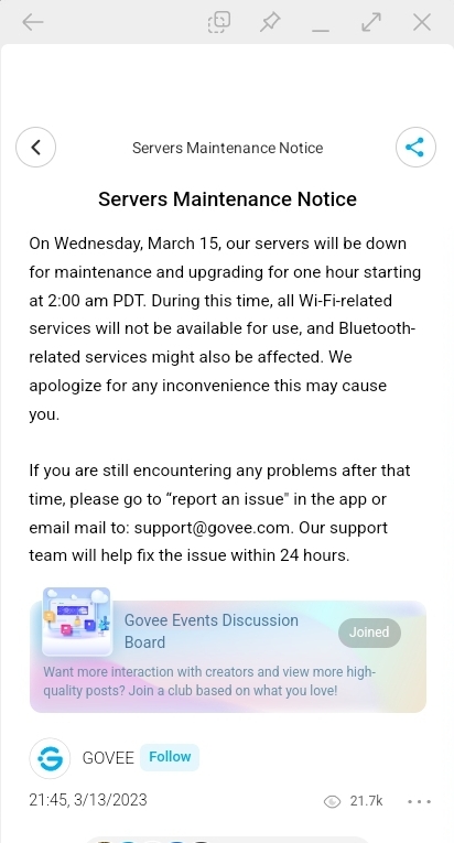

To everyone else Govee is doing system maintenance on there cloud system tomorrow I just saw this in their Govee Home app. Looks like they will be doing system maintenance tomorrow morning and we may have an outage for 1 hour. If it goes much beyond the time window shown in the screen shot below you may need to reach out to Govee support to start a ticket. Hopefully this means we have some updates to the GoveAPI coming.

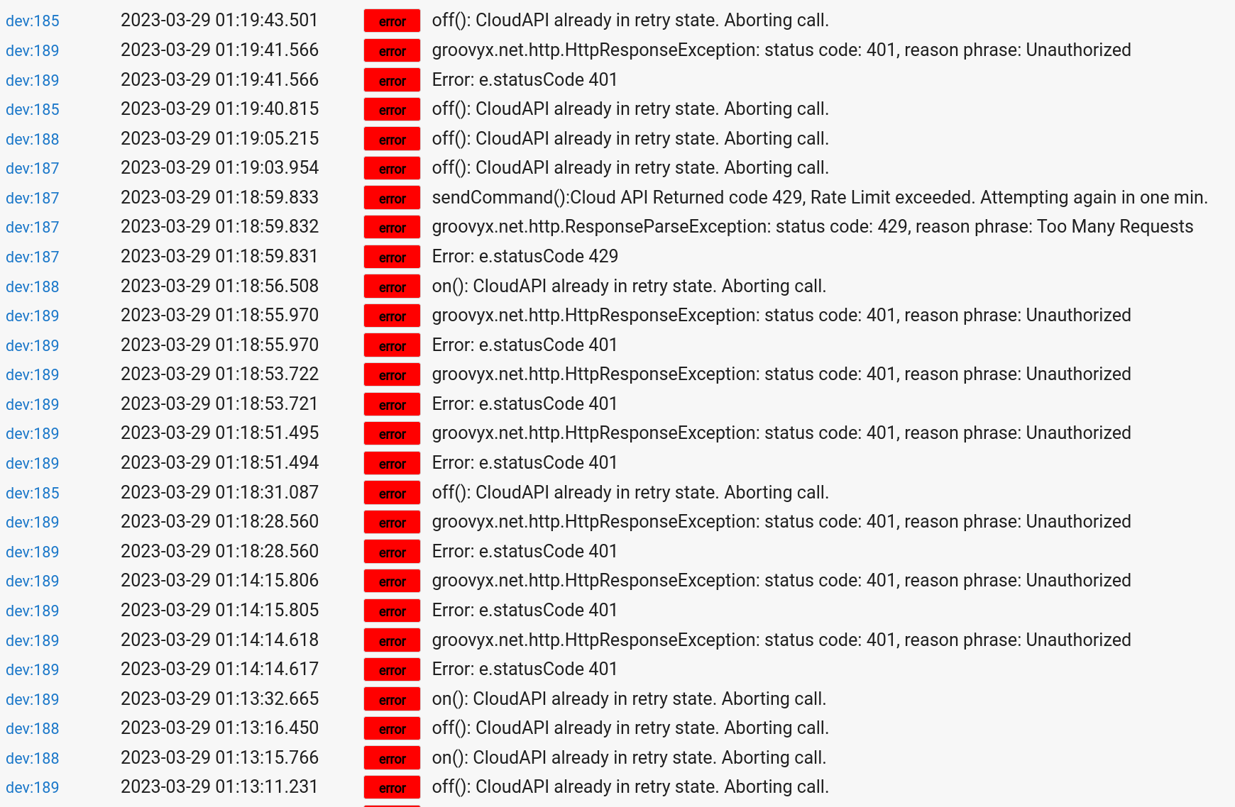

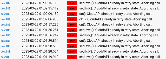

it seems that something with API calls not right, i don't seem to be able to manage my light-strips (sometimes it works sometime dosn't)
This looks like two issues.
You have allot of references of "cloud already in retry state. Aborting call" and i see a few occasions of error status 429. Thise indicate you are hitting rate limits. Please remember we can only make up to 10 calls to the API in one min. Some actions take multiple calls. So that may be reduced to five. In those cases.
You also have several references to "unauthorized" and that makes me wonder if there is a issue with your token.
How many devices do you have? Do they just work for a short time and then fail. Or are they just not working at all. What do you have your soft poll value at? What are you trying to do when this happens?

The unauthorized error is strange as i think that points to a issue with the token. Maybe request a new one?

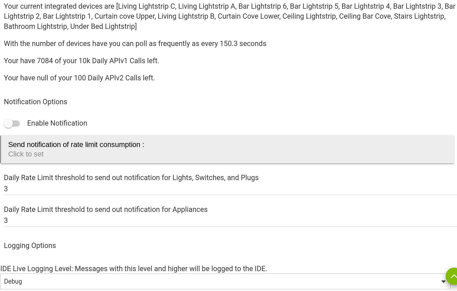

There are two rate limits for the Govee V1 Cloud API. I explain it in this post
The numbers I provide in the Integration app are for the total 10k per day, but do not address rate limits on each individual device. That space is important to understand how your polling settings are potentially impacting your daily rate limits.

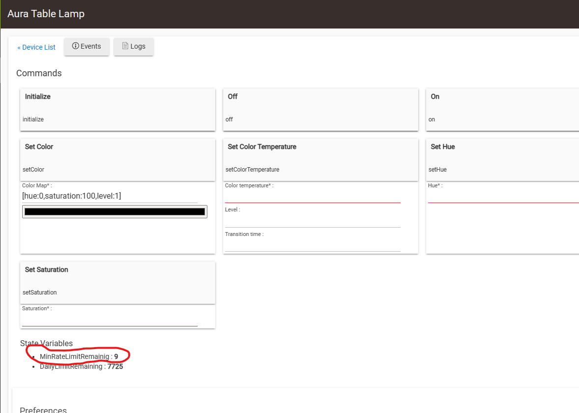

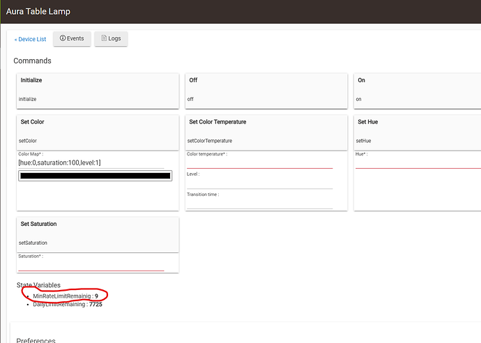

If you look at the page for the device you can see the rate limit as it is circled below. The state values don't update immediately though so you would need to refresh the device page to see the most recent value if you have been pushing on buttons in the UI.

I have managed to resolve it thank you @mavrrick58 I've tried changing API key further that didn't work, and actually put all lights to cloudAPI status to Retry
so I removed the entire Govee app from HE, and installed again with the new API key, which worked smoothly, but further more I did your suggestion for Local LAN API, and man that is so quick so smooth, it take some time to identify each light MAC from Govee android app >> reserve IPs at the router >> Activate LAN Control (from Govee android app) >> then back to HE govee device(s) one by one to update the IP of each light..
