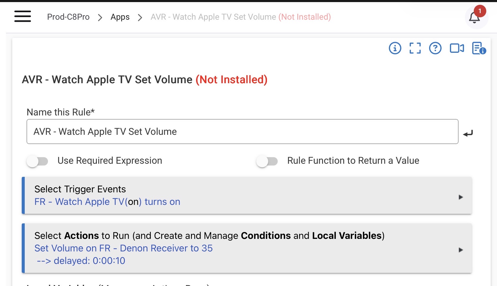

Assuming you are using the built-in Denon receiver driver, you can simply use the Set Volume command in Rule Machine.
Here is an example.
I am able to set up the app to set the volume to a set level, but I want to have a pico button be a volume up button, and another pico button to be volume down
Thanks in advance.

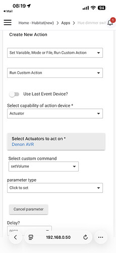

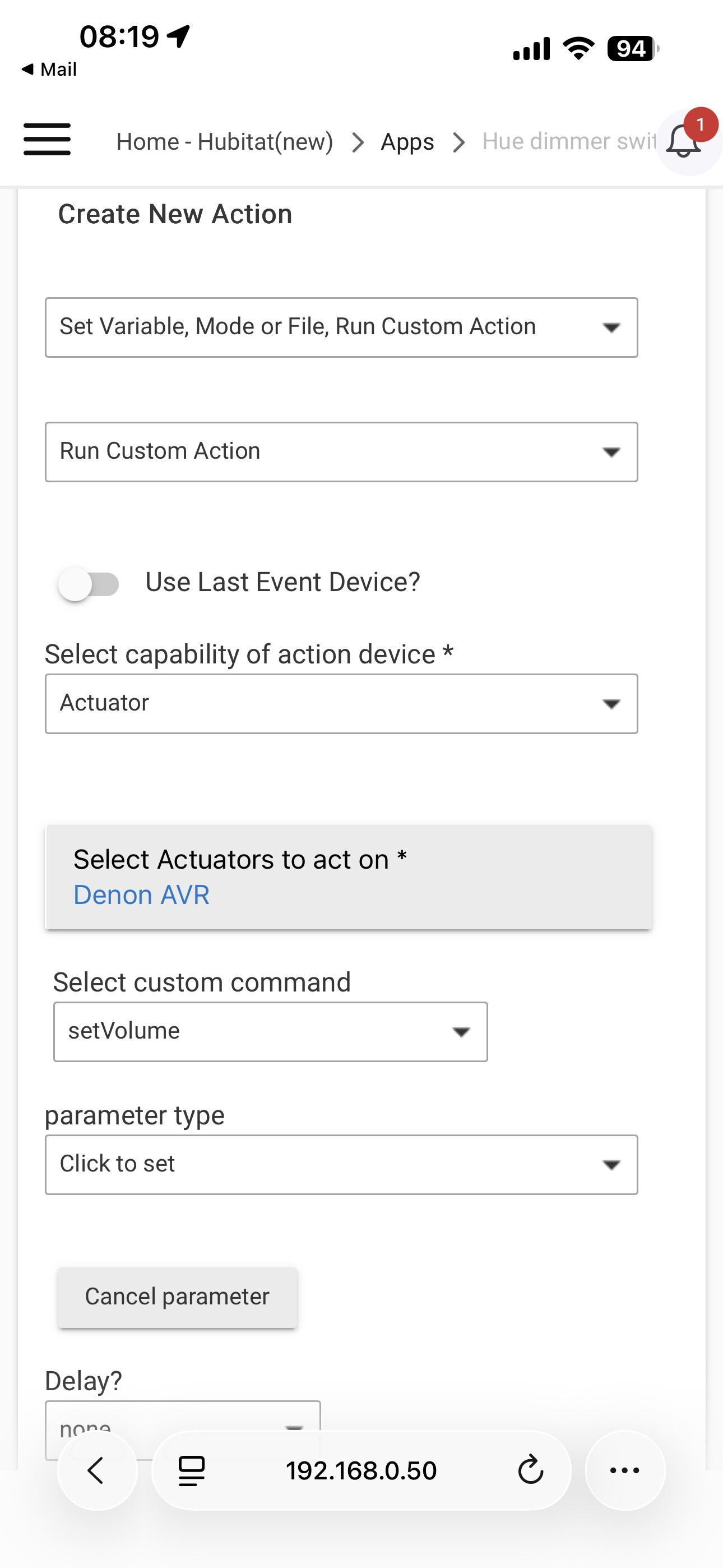

You can use Button controller app. You set an action for each of the Pico buttons. It’s not obvious (until you know) how to see all commands available for the Denon. What you need to do for your actions is ‘run custom command’, select the capability as ‘actuator’, then pick your Denon device from the list. That’ll allow you to see the full list available in the driver including ‘volumeUp’ and ‘volumeDown’. You’ll probably want a way of using the button to increase by an increment otherwise you’ll be only increasing 0.5 for each press (frustrating). There may be a way to use double tap or held for that. Perhaps someone may know how to look at the current volume and do +2 or -2….
Edit: Ignore setVolume as the selected command below - both volumeUp and volumeDown are available

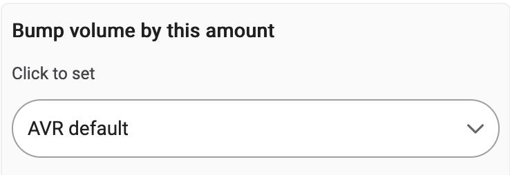

I have several 5 button Picos around the house that control volume for the room the Pico is located. I am using a Juke Audio multi-zone amp for these rooms, not a Denon AVR, but I do own one for my main family room (so familiar with its capabilities). Personally I use the middle round button for mute, the up arrow button just above for "volumeUp" and the down arrow just below for "volumeDown". Those are commands that are available on the Denon and other "music players".
Your Denon device even has a preference to set how volumeUp and volumeDown work:
