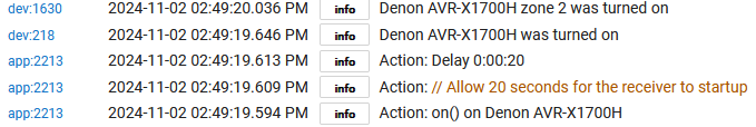

Are you sure? Can you please create a rule to test using this action:
Enable rule logging:
And device logging:
And share your logs.
Well you are correct zone 2 and zone 3 turned on along with the main zone. I know it didn't used to be this way. But to be honest I don't use HE to turn on the main zone, only off and only automate Zone 2's on.

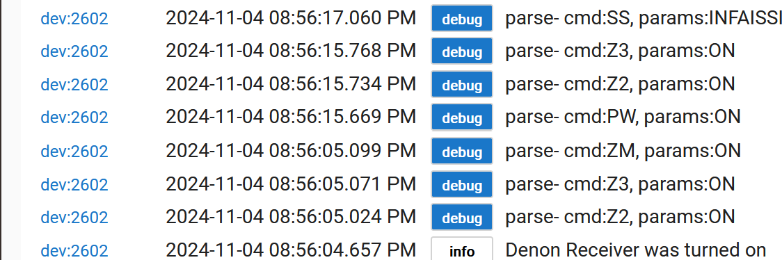

@mike.maxwell did something change with the Denon driver where Zone 2 and Zone 3 automatically turn on with the main zone? If yes could this be disabled or maybe a preference to control that? Debug logs invoking on() on the main device:
Nothing with this driver has changed
Thank you for confirming. I honestly don't automate turning on the main zone so this has probably been the case for years when you helped me create the original driver.
I did some more tests with debug logging and see that PWON is being sent which does turn on all zones. @mike.maxwell Could you possibly change that to be ZMON instead or have a preference to switch between the two? Then off should also be ZMOFF in case users want their other zones to remain on. PWSTANDBY will turn off all zones.
