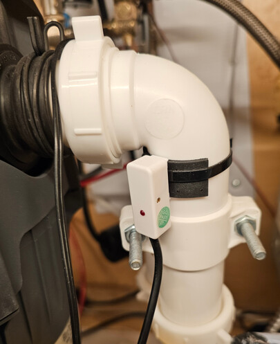

For this spesiffic reason I mounted a simple "capacitive liquid sensor" on a drain pipe from insinkerator. HE sees it as an Contact Sensor. The RM rule will not turn on a Garbage Disposal if there is no water flow detected. And automating a Garbage Disposal is the only a reason why I need Touch2O to be controlled by HE (better without any clouds involvement). I should do DIY control long time ago but I was too lazy and bought VoiceIQ just for this reason. Now because Delta is playing games the time came for the DIY (no cloud) solution and it is already done.

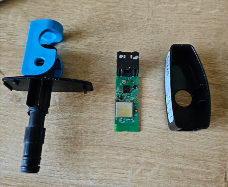

UPDATE on VoiceIQ.
It happens to be opening a VoiceIQ case was not a big deal:
The electronic board is pretty much usless for converting it into custom device. SW is encripted, CPU is not an ESP32 but anyway it is locked for the reprogramming.
However Water Flow Sensor definitely could be reused. All waht is neded - is to mount Hall Effect Sensor to the plastic tube. And the location is known. So, I might be able to add valume monitoring and control capabilities to the ESP32 project. Frankly, I don't see any use case for this but I may try to play with this toy.

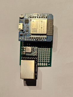

First of all - I am glad to hear the Delta cloud-based integration is still alive. However this intergation is a cloud-based. I am desperately trying not to use anthing clousd-based and I am very happy if i can get reed of whatever cloud. Recently I was able to create a DIY ESP32/Hubduino controller for Touch2O Delta Module. Here is a finished, tested and deployed controller board (box is co0mming):
Current version only sends a Valve Open/Close commands and reports correctly Valve State even when valve is manually controlled.
I collected enough reverse-engineered info for adding Temp Monitoring but frankly I don't need this info for any automations.
I was able to open safely VoiceIQ Module. The existing VoiceIQ board cannot be reused because the fimware is encreppted but was is worse, the hardware locked for the reprogramming. However the Flow Sensor definitely could be reused. I place a Hall Sensor in the same spot where on board sensor is/was located and I can see a very clean singnal. The minimal detected flow rate is something like fast dripping. So, volume measurument and dispencing could be added but again, I don't see how to use this info in automations.

I am confused. If I want to implement a dispensing function it will not be based on time and assumption that valve is 100% open. VoiceIQ is using a turbine and a hall sensor. This turbine definitely could be reused. Just in case I testted a turbine with hall sensor placed in the same place where the original one was located. The signal is nice and clean. So, the exact valume could be measured precisely. But I am not planning to add this function as well as reporting temperature simply because I don't need them for any automations.
