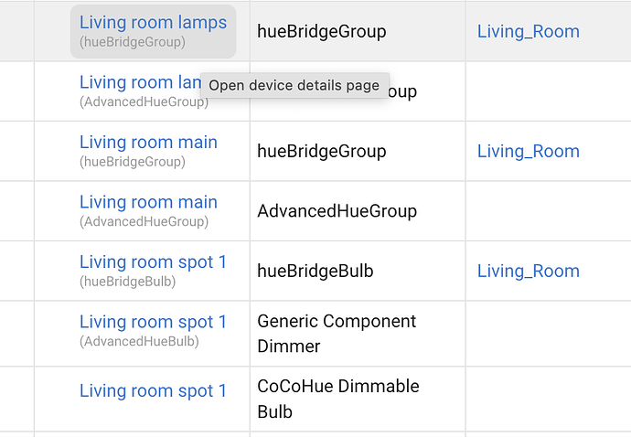

What devices, and where exactly are they listed? A screenshot may help explain better.
If you are using multiple different Hue integrations, northing is stopping you from adding the same device multiple different ways. That could cause one "problem." But it still doesn't explain Rooms if you mean the Hubitat feature. Hue does have a Room/Zone/group feature, and most integrations let you import those into Hubitat as well. On Hue, you can add a device to,multiple zones (but I think just one room), though that's not a Hubitat issue per se.

This is part of my device list, but replicated for all rooms and all lights... each one is in hueBridge group and AdvancedHue group &c...
It looks like you setup 2 to 3 different Hue integrations and have brought all your devices in multiple times. So you need to pick which integration you want and then remove the other one. Or you can mix and match if one works better for certain things, but you would want to remove the duplicate devices from one of the integrations to clean things up.
Was going to say the above--this is basically the issue you mentioned out a couple posts back. There's nothing wrong with it, but it's not normally something I'd recommend unless you need something from one integration the other doesn't provide (though I can't imagine the built-in integration would be one of those...).
It can also contribute to load on your hub if you're using polling (the only option for the built-in integration and the default in at least CoCoHue) or eventstream (available in both the custom integrations you have) -- and most people are probably using at least one of these features -- so that's another reason you may not want to, besides confusion.
Check the "In use by" section on each device detail page before removing any you don't want to see what apps are using it, then swap it out for a device you want to keep if so. Once you've removed the device from any apps it's in use by, it's safe to remove either the device itself or (if true for all devices created by this integration) the integration itself.

For each app you use, it will create an id of sorts for hubitat to use. So using the built in hue integration will create an id for your bathroom switch, but then you add cocohue and bring in that same switch it will create another switch with a different id... ...(I'm being really simplistic here as I don't do programming myself, I leave that to people like @bertabcd1234 and @jtp10181) So really Using just one integration is all that's needed. Use the one with the most features,
The hub does not know those are the same devices, they were imported from different integrations apps. For all the hub knows you have 3 different Hue hubs with devices that have the same names.
