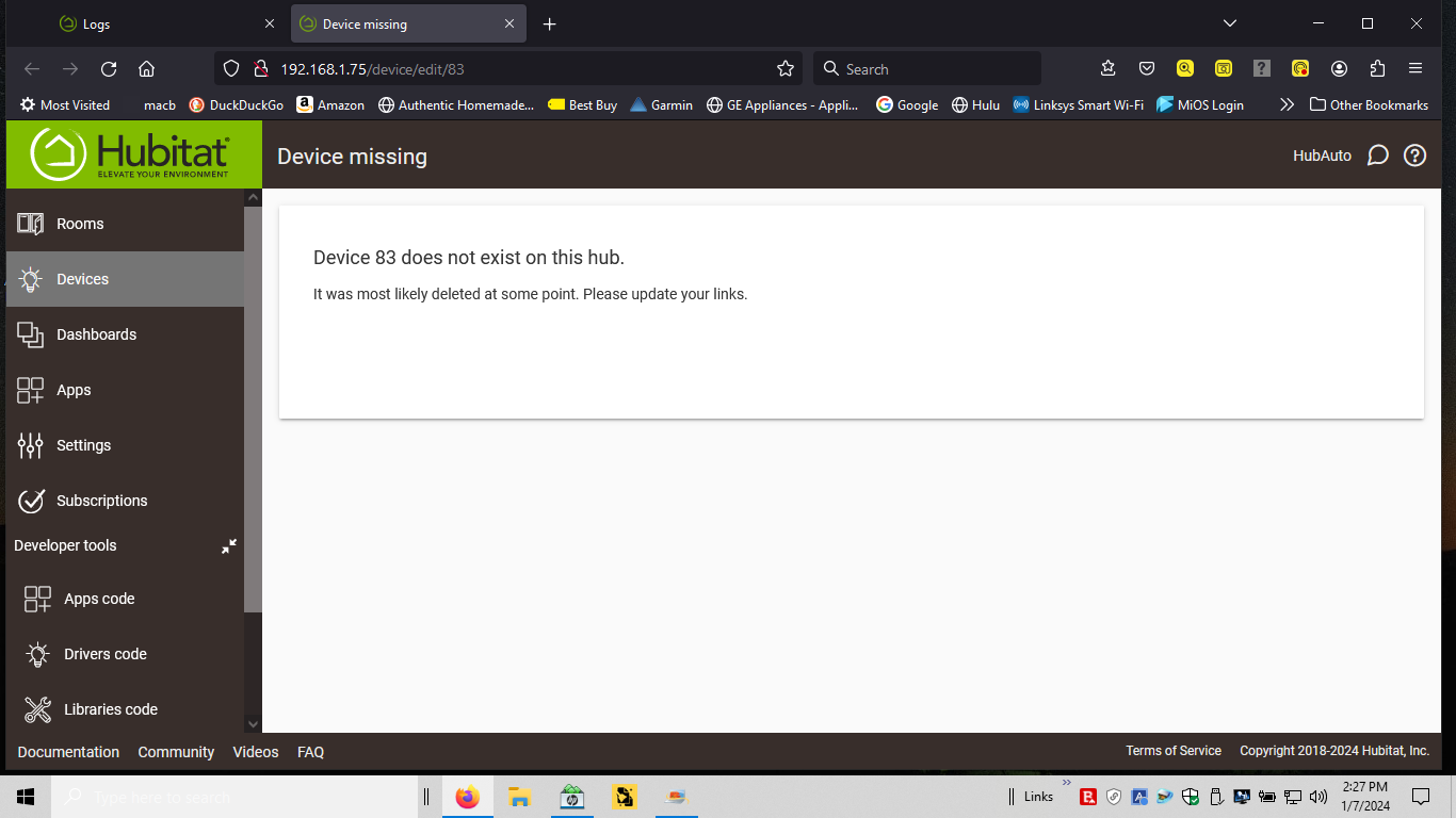

My problem is I noticed in the logs that it is showing the 3 failed sensor and when I click on it, it says "device 83 does not exist on this hub" "it was most likely deleted at some point" "please update your links". It shows a different device number for the other 2 failed attempts. My problem is since I'm fairly new to hubitat and troubleshooting problems I could not find or figure out how to delete and update the links.

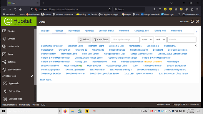

So I figured I'm looking good till this morning every light thats on z-wave came on for no reason (meaning by a rule) so I clicked on one of the z-wave light switch in devices then clicked on logs to see if I can try to figure out what turned on 10 lights at 5 am this morning and looking at "past logs" is where I saw 3 entries of zooz zse41 open close sensor. It is still there and in fact I noticed as I looked at all the devices in the "past logs" there was one called linear/vision siren. That one popped up when I was doing an Ultraloq door lock inclusion last week so I did an exclusion of the door lock then a factory reset of the lock did an inclusion and it came up correctly this time, back then.
Anyways if I click on the linear/vision siren or any one of the zooz zse41 devices on the "past logs" page it states what I said on my previous first writeup. Where it says "device does not exist, please update your links".

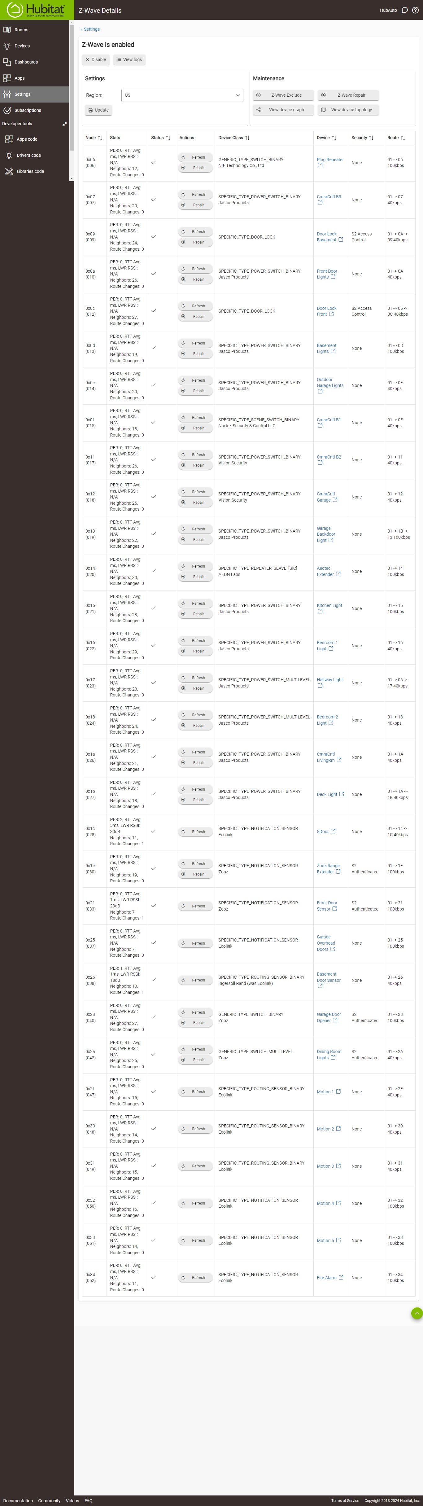

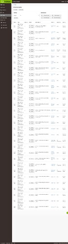

I still suggest you post a screenshot of your Z-Wave Details page. It might take a few screenshots for 31 devices but that is ok. I believe the key to troubleshooting your problem is in the Z-Wave Details page,

Is there a way to shrink the page to get more devices on each page it only shows 3 devices at a time and also get rid of the left side to widen it?

Not sure what browser you are using. I use the Gofullpage screen capture extension with Chrome.....https://gofullpage.com/
ok i guess that didnt work to well
so here you see the past logs page and it show 3 - zooz zse41 open close sensor and the linear/vision siren but if you look at the z-wave details nothing there and the other screen shot you can see it say device # does not exist on hub pease update your links.
I just want to know what updating your links mean. I'm assuming its got something to do to delete these devices.
There’s a good chance that this is just leftover crumbs in the log.

I don't think the purge logs at reboot option is working - it's a new feature, and I've seen many reports that it's not actually purging logs.
If these are just relics in your past logs, I wouldn't worry about it at all - they'll eventually purge out of the logs on their own.
I would agree that these just look like leftover crumbs in the log. Your Z-Wave details look good. I do not see any ghosts or any issues. Not sure why the lights came on at 5 am. Suggest you keep the logs open and if you have any more problems post a screenshot of the log events
