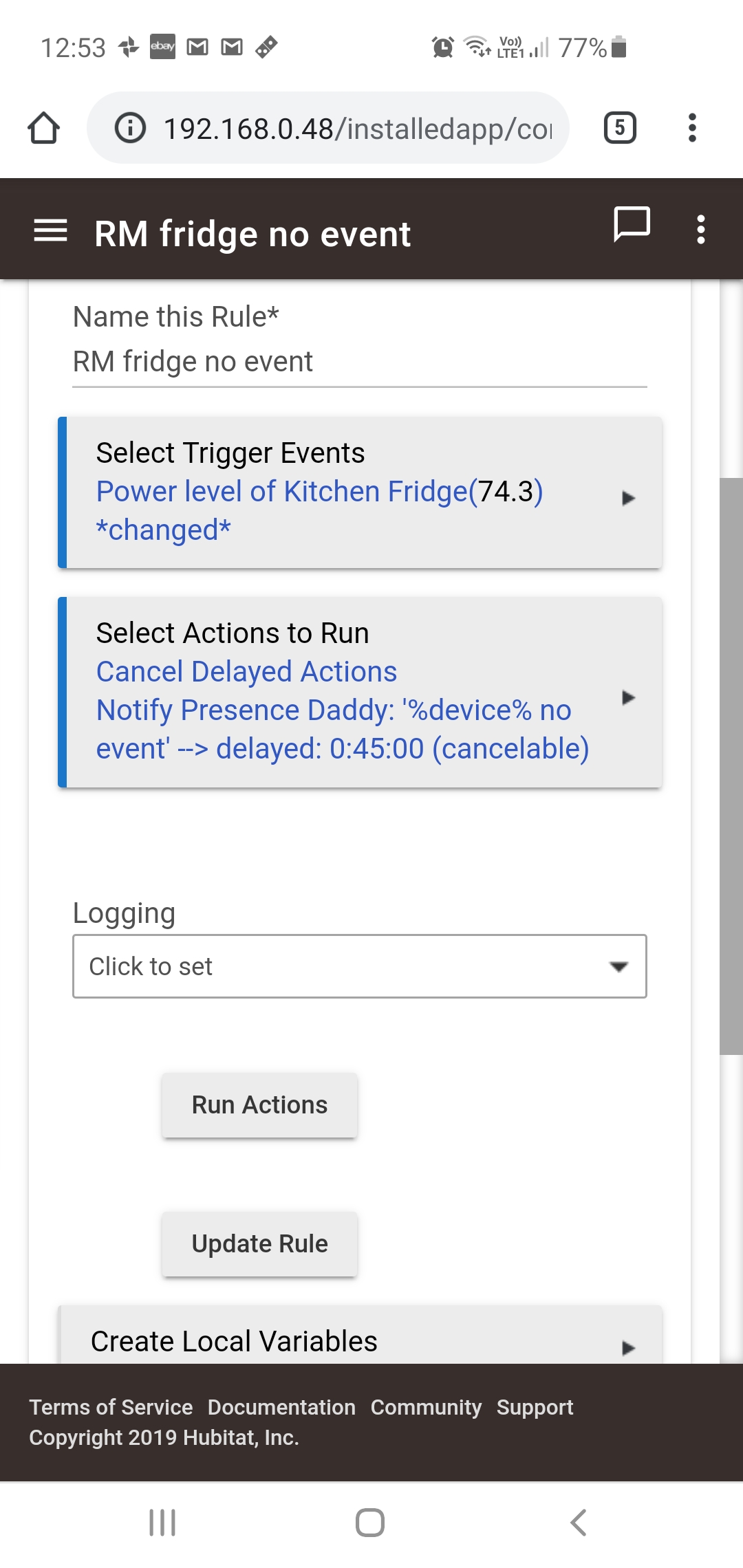

My understanding is it over writes, how ever I always like to put canile delayed actions in
