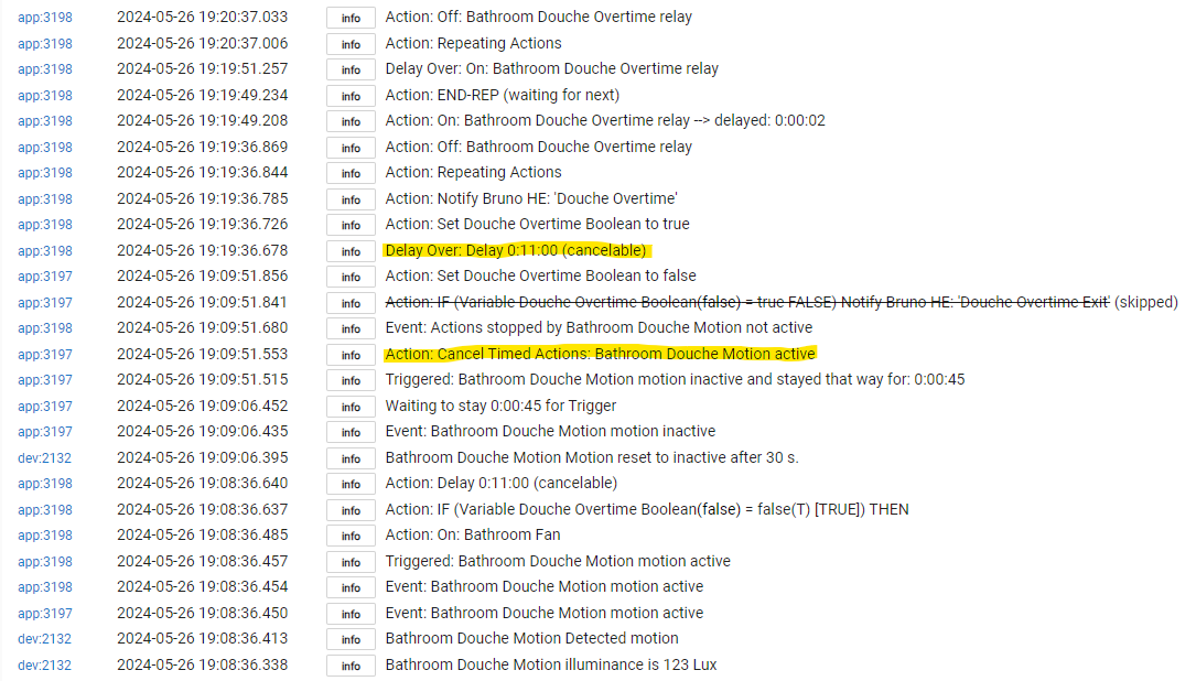

Delays or Cancel delays not working since 2.3.9.136 on c8-Pro

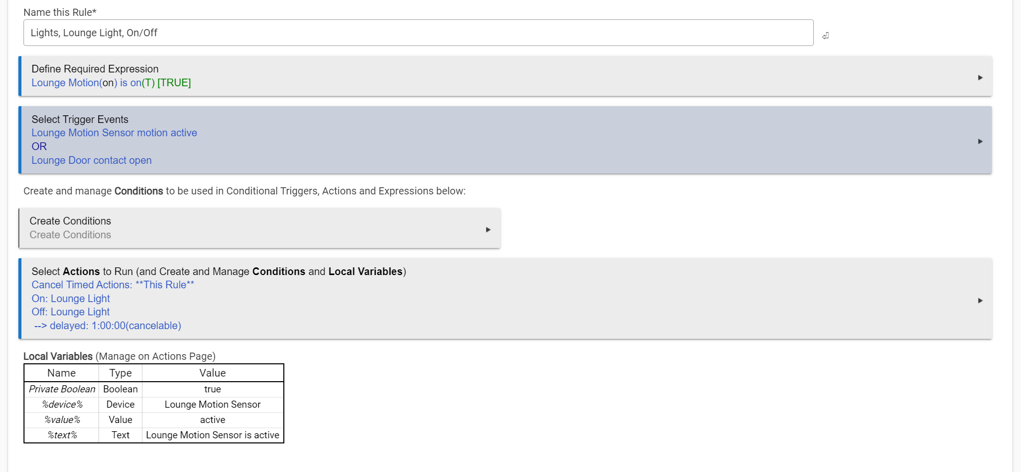

I have several rules to automatically turn off lights, all similar to this, triggered by motion in that room...
Since the last release, the timers do not cancel or get reset when motion is detected, so after an hour, the lights just start turning off for every motion that was senses 1 hour earlier.
This has been reported here and is being investigated:
I'm not sure if it will make a difference in outcome (with respect to this problem -- it won't normally), but in your rule, "Cancel Timed Actions" is overkill and a simple "Cancel Delayed Actions" would work if you have not tried it that way already.
Will change the rules to try that. Thank you
