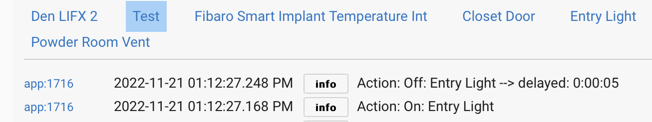

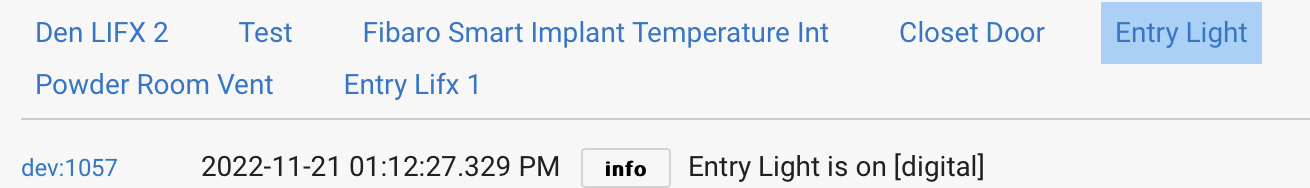

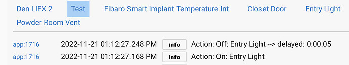

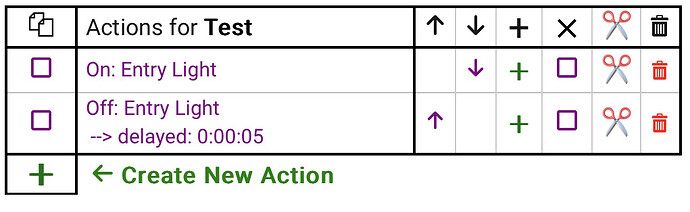

In C7 hub running 2.3.3.140 and in both rule machine 5.1 and 4.1 my delays have stoped working. I built this simple test to confirm my suspicions of the weirdness in my environment, and the light did not turn off when i set the delay and there is no off event in the logs either. I turned up logging on the piston and i see no errors and i soft reset the hub and restored from back up just in case and my delays still dont work.
Is there something else I’m missing to get delays working again?
