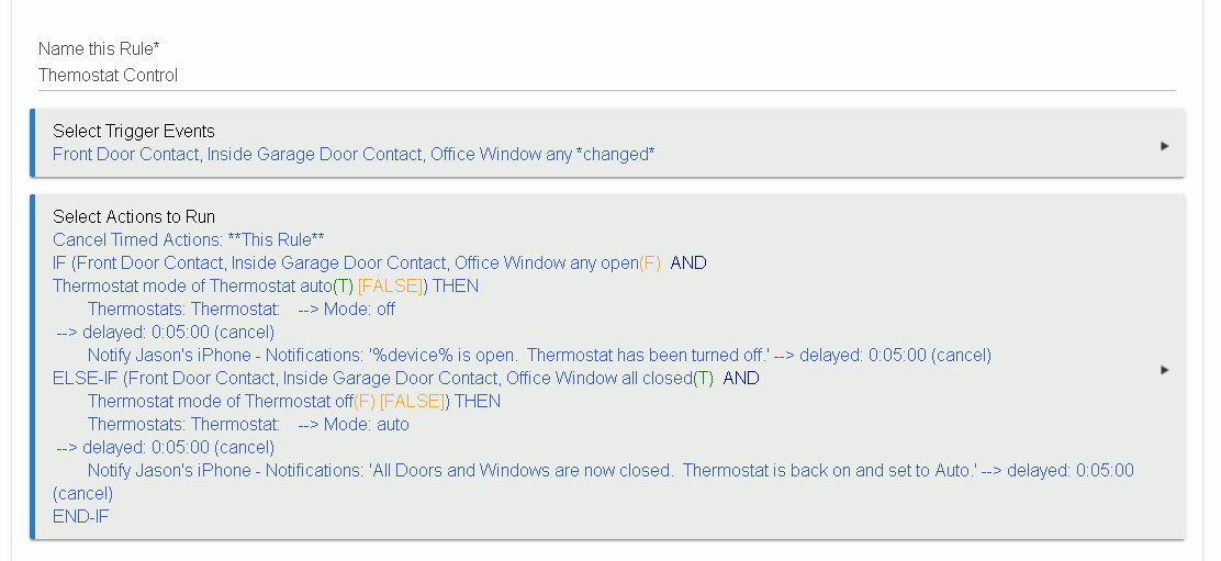

I guess I'm not understanding how this could be written any different to do what I'm trying to accomplish. I looked at the wait commands but there's no "wait" with cancel on truth change, thers wait for an event or wait for a condition... perhaps you're saying I should wait for the contact sensor to be open for 5 minutes with a cancel on truth change? I suck a rule writing... sigh
How about this? Don't use the Delay action, put the delay on the individual action then you can add a cancel to it.

I think I've finally gotten it!
The only thing that you might want to think about is if you have multiple doors or the window opened during the same 5 minute period. A second opening would cancel the first opening delay causing the thermostat to stay in auto for longer than 5 minutes with something opened. If it's an unlikely case you should be fine.
Good to know but the end result would be that it takes 10 minutes to shut off the thermostat. One in which I can live with. Thank you!

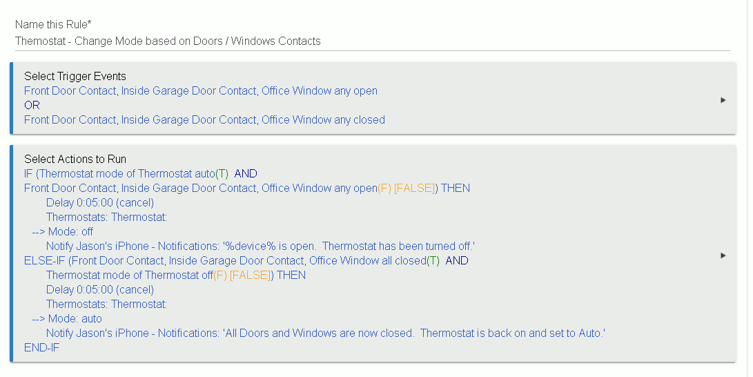

You also might want to insert an action of delay rather than use a delayed action. Delayed actions all get scheduled at the beginning of the block of actions, then the rest of the actions happen. So, you are scheduling a delayed action and then immediately canceling it. This is what the order of operation when any of your contact sensors open and the thermo is in auto mode:
Schedule delay of Thermo Off
Schedule delay of Notification
Cancel all delayed actions
The last one will cause the first two to not happen.
