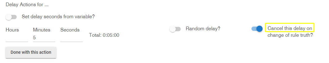

Delay with Cancel on Truth change not working
Unless I'm missing something, this:
Does not work.
Even though the Switch was turn off (->Truth Changed), the following action was not executed.
Looks like the hole rule is stopped and not just the Delay.

Cancelling a delay cancels everything after it. A delay suspends execution of the rule actions for some period of time. If the delay is cancelled, it never comes back.
Explain what you're trying to do.
OK, so maybe you should change the description of "Cancel this Delay on ..., because it's a bit confusing.

You make a good point about Cancel "this delay". For the case of a delay attached to an action, it should only cancel that specific action. This is in fact what it does. Because that particular action has been hung off a timer, cancelling the timer means that action won't run. Other actions after that delayed action have already run.
For Delay Actions it is less clear what to do with cancel. The whole idea of cancel is to cancel some delayed actions. So, in this case it makes sense to me for everything following the Delay Actions to be cancelled.

This is the way it works. A delay on an action does not delay the rest of the actions after it, so cancelling it only affects that action. Cancel on truth change is still in Rule 3.0.
Understood.
But I was just using a simple Delay and not a Delay on action.
So if Cancel on truth change is still in RM 3.0, The Cancel This Delay on truth change is ... a bit useless don't you think? We just have to turn on Cancel on truth change to achieve the same thing.
