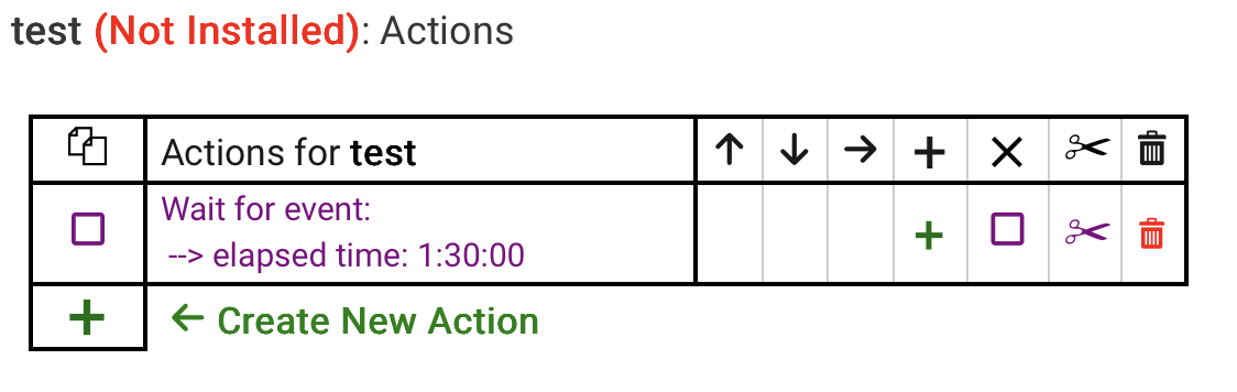

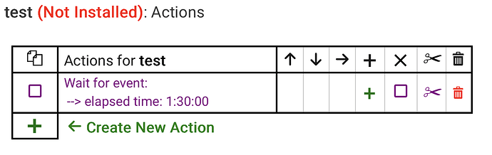

I vaguely remember that a WaitForEvent was better than Delay...for whatever reason. Maybe I didn't even remember correctly.
WRT to accuracy, there should ve no difference between a Wait or Delay.
The difference between them is related to cancelling (see blue box here).
