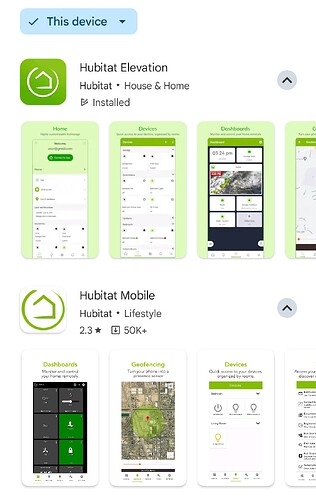

  7. I decided to uninstall HE from my mobile device and reinstall it. To my total frustration I discovered TWO seemingly active HE apps, one called "Hubitat Elevation" and one called "Hubitat Mobile" with no obvious description of which is appropriate for my mobile device (both are listed as compatible with my Android OnePlus 7T Oxygen/Android 12 phone). I had been using the "Hubitat Elevation" app all along. I tried the "Hubitat Mobile" app. and it discovered a hub but the IP address was different (I only have one hub on the LAN with a static/reserved IP address. And when I tried to "claim" this hub in the app, the "claim" button appeared dead. So which of these two apps should I be using and why are there two seemingly active apps?

I can’t say with any certainty since you’re using android.
But for iOS, there’s a version 1 of the mobile app, and a version 2. I believe the same thing is true for android.
If I didn’t know which one I was using, I would check the App Store.
This is version 2 of the app in the App Store:
This is version 1:
Perhaps you can do the same with the google play store. Or check the settings of the app installed on your device. The version # is probably listed.
Believe it or not, there is a reason why two different app versions exist at the same time, but that’s not entirely relevant right now.
Once you’ve determined which version of the app you were using before you accidentally deleted the mobile device from your hub, and de-registered your account, please confirm here.
Next steps may depend on which version of the app you were using. I suspect it may have been version 1, if you didn’t download version 2 sometime within the last year.
Below are the 2 apps on goggle play. I was using the first one, "Hubitat Elevation" and that is what I have installed now. That one says there is no hub registered to the account and no apparent way to register it. However, logging into the account from my PC on a web browser, it shows that the hub is registered to the account.

The version info is presumably there in the play store, if you still care enough to check it. I think you might have version 2 there, but I’m not sure.
The reason there are two apps is that the version 2 app was significantly different enough from version 1 that it wasn’t just an upgrade/update of the same old app.
They weren’t intended to co-exist indefinitely, but since the version 2 app was released, some android and iOS users have noticed functionality they had in the old app that either doesnt yet work right in the new app, or isn’t there at all yet.
The staff have said they’d extend the planned sunset of the version 1 app til they’ve squashed enough bug reports for version 2.

The version info is there in the Play Store but it's not displayed at the top-level w/the apps, you have to drill down one level into details for the apps to see the version, so easier to be confused on Android about which is the higher version.
I think the color pattern of the app icon is consistent across OSes.
White logo on green background for v2. Vice versa for v1.
