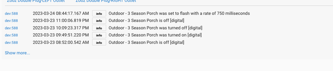

Updated to 2.3.5.117 this morning, and noticed one of my switches stopped responding. Additional suggestions for debugging?

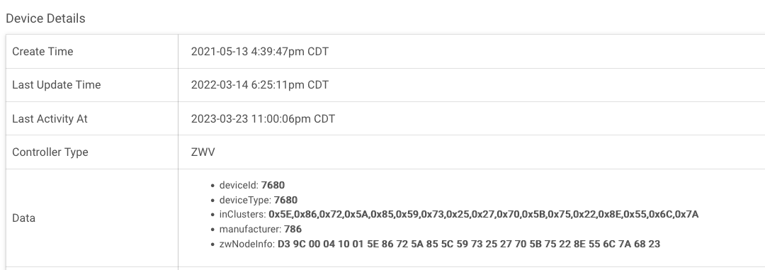

Zwave devices do not typically un-pair themselves unless they get factory reset somehow.
