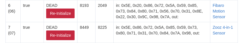

I've seen this now 3 times today. I re-initialize them and they sometimes come back to a normal state. However with the Fibaro I just clicked the re-initialize and it went to UNKNOWN and is now back to this state. Is this how "sleeping" sensors are shown in the Hubitat interface? The fibaro and zooz are both still sending data. I've verified that in the log.
I see this with the Aeon minimotes after a while; they go back to normal when you use them and wake them up.
I also had an Iris 3210-L zigbee plug (not the new firmware version) with Z-Wave repeater show ‘FAILED’ and then later ‘DEAD’ on the Z-Wave side after a while (the Zigbee part remained working fine). I excluded it and re-paired it and so far it still shows normal status.
