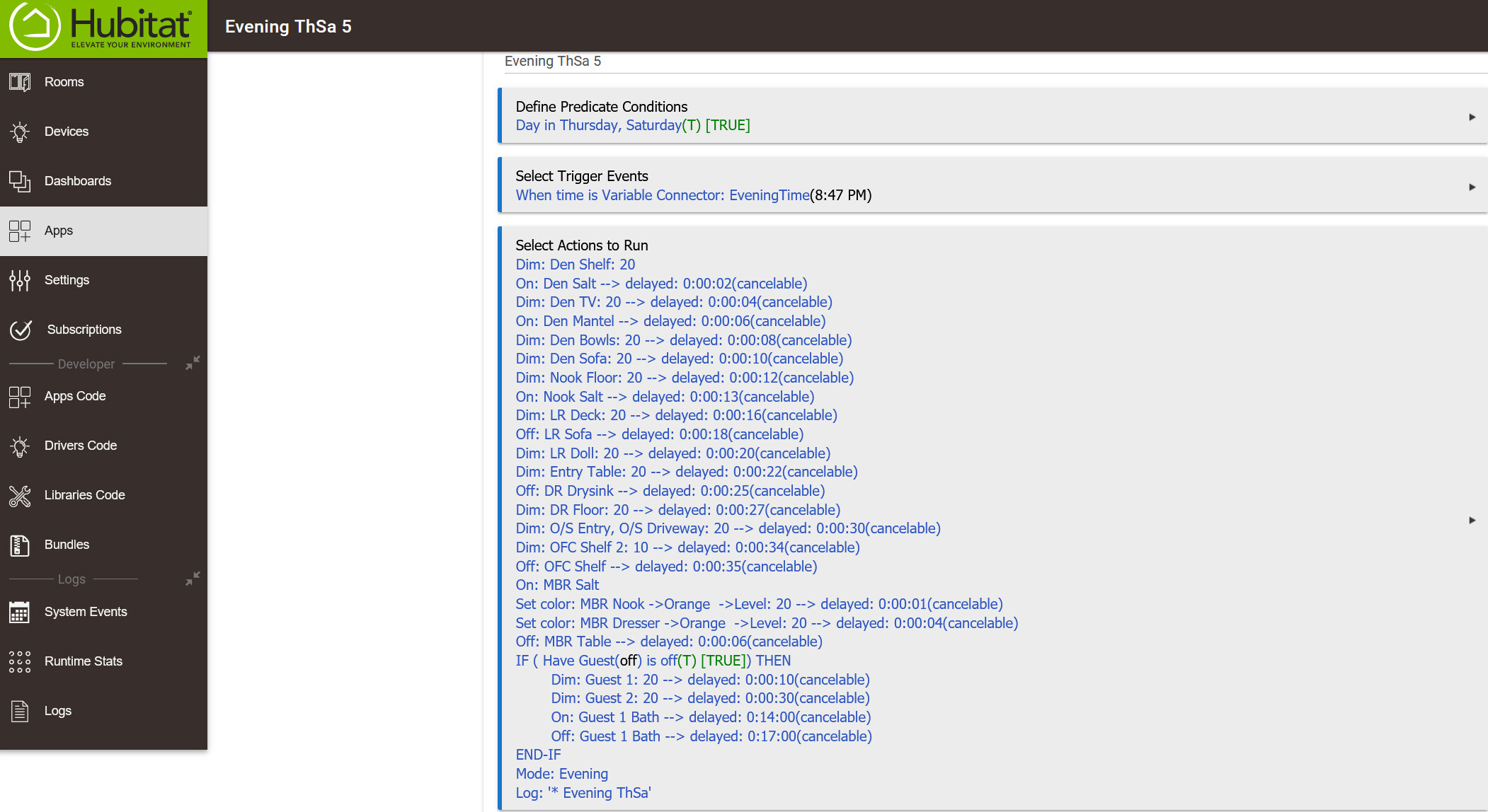

If you have a rule that "double triggers", I need to see logs of that happening, a screenshot of the rule, and the full App Status page. Show me....

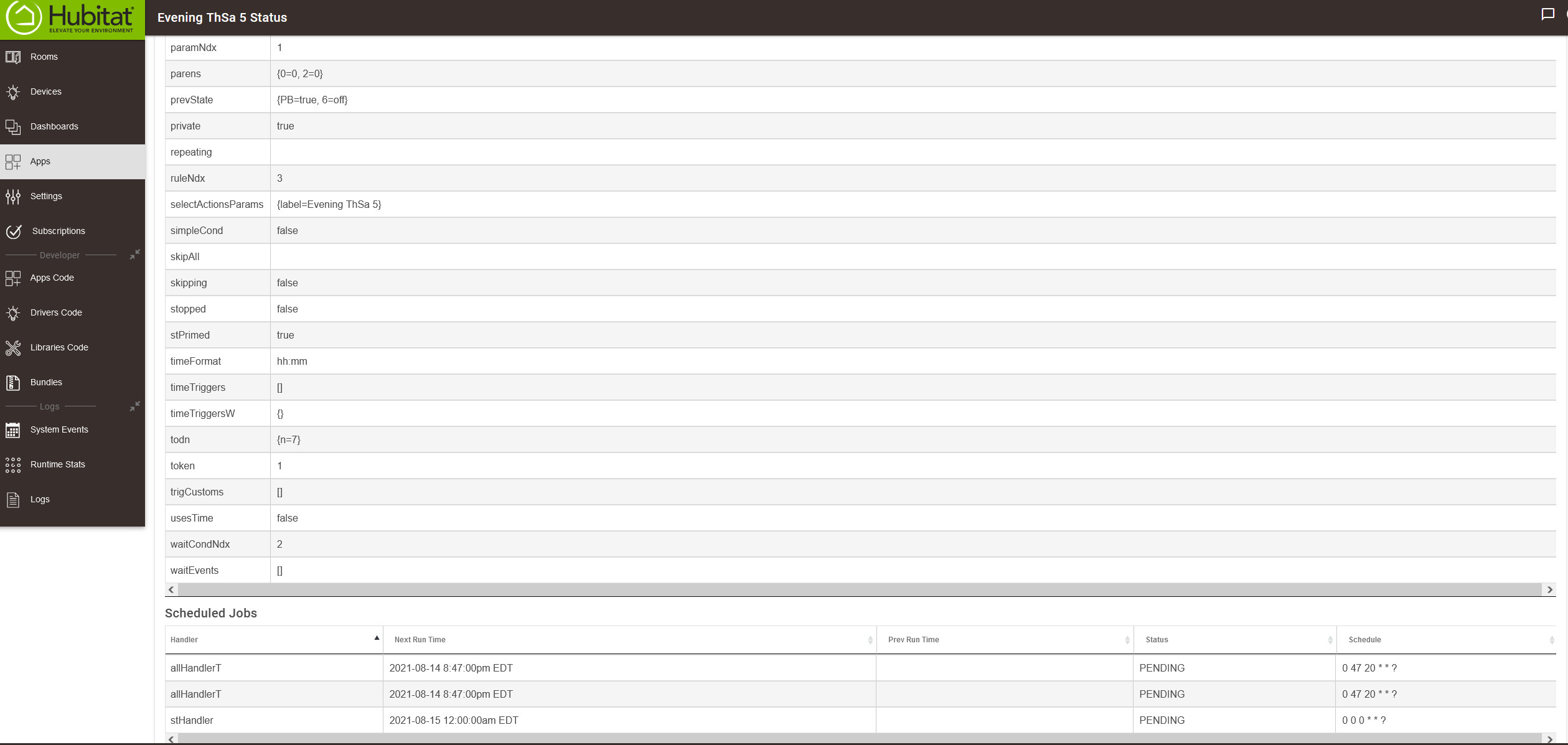

OK - I've got a rule that sure looks like its going to trigger twice tonight - there are 2 jobs scheduled at the same time. How do I get that "full App Status page" that you want to you? There's a lot of screens...
OK, show me the rule and the Scheduled Jobs at the bottom of the App Status page.
Please open the rule, hit Update Rule, and then see if there are still two events for the same time in Scheduled Jobs. If there are, I will need to see the portion of Application State from the App Status page that has the words starting with the letter 'c'.
Also, if there are two events scheduled, try removing the Trigger Event completely so that there are no Trigger Events at all; hit Update Rule, and then recreate the Certain Time trigger. Then hit Update Rule, and see what the Scheduled Jobs are.
Update rule then Done - only single event now. FYI - I did what you suggested removing the trigger, saving, putting it back in - days ago to all my datetime triggers when this first appeared; it evidently still comes up.

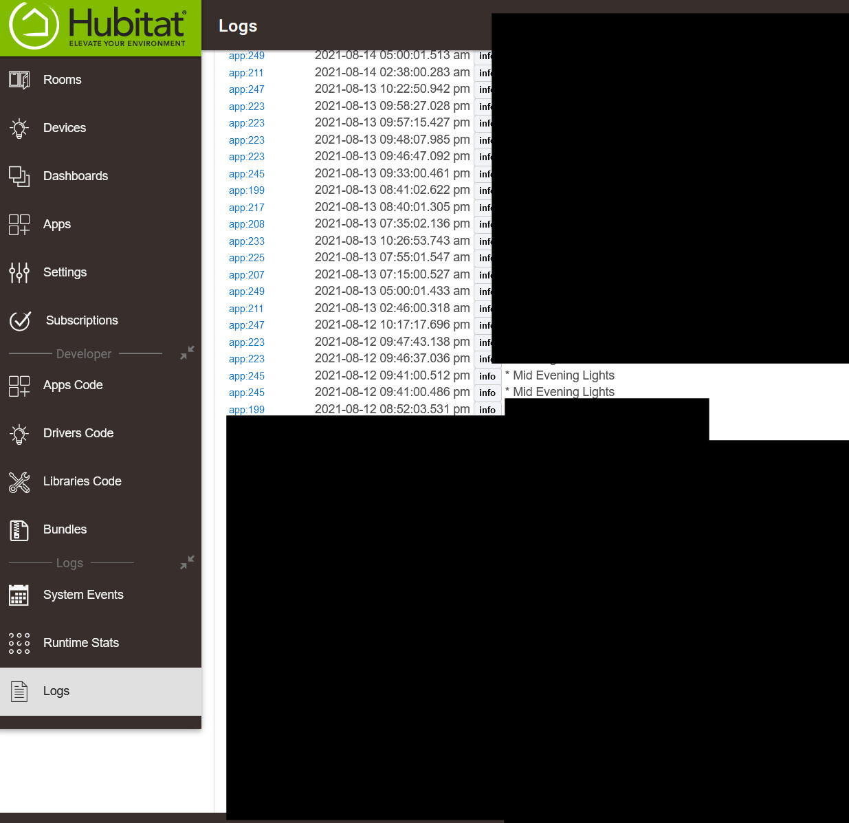

Here's a log of another datetime triggered rule that happened recently

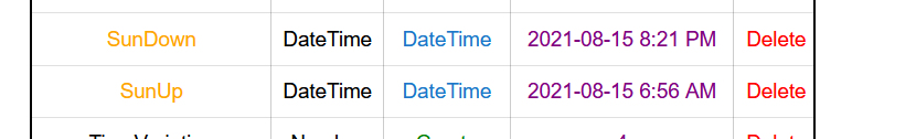

I also have 2 hub datetime variables on dashboard tiles that are not showing the correct value – they are hub variables assigned to sunrise and sunset. Reboot doesn't help.
Again I’m not sure if this problem has to do with them perhaps being created with a release that had an issue?? So I still don’t know if these datetime variable issues (double triggering/dashboard values) are current defects or of I just got caught up in the releases. I’m not looking forward to rewriting all those variables, but if the code is solid now in this area, I’ll do that; obviously I don’t want to go through all that work if it isn’t going help. Suggestions?
dash
Those variables are given a new value each day in a rule that fires off at 5 am. Other datetime variable values are updated correctly on the dash, but not these 2 - even if I reboot or refresh. However, if I manually edit the times - not change it, just click update on the time setting, it will then be correctly updated on the dash.

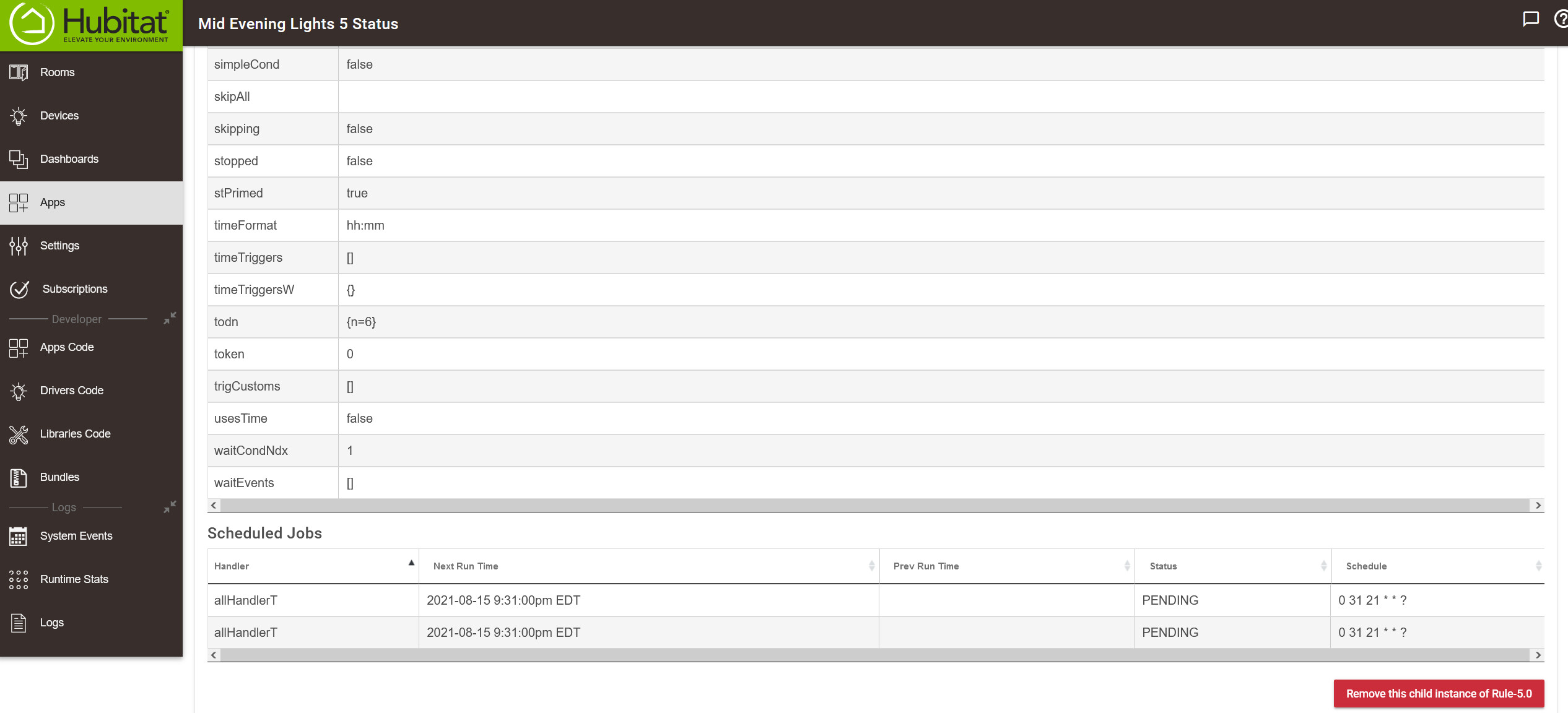

I checked all my datetime connector triggered rules' schedules yesteday when making the posts - and we corrected the only one with double entries for scheduled events. Today, one of those other rules has a double schedule entry; again, yesterday, it didn't have that. Something is not right with those variable connectors on my system.
What has transpired in the past day with this rule, in general terms? Was the connector value changed during the day by anything?
Yes, all those hub datetime variables get set at 5:00 AM, all based upon the day's sunrise and sunset values.
Do you still have the one with double schedules? Even if not, please show me the Scheduled Jobs section of its App Status page. I will try to replicate...
