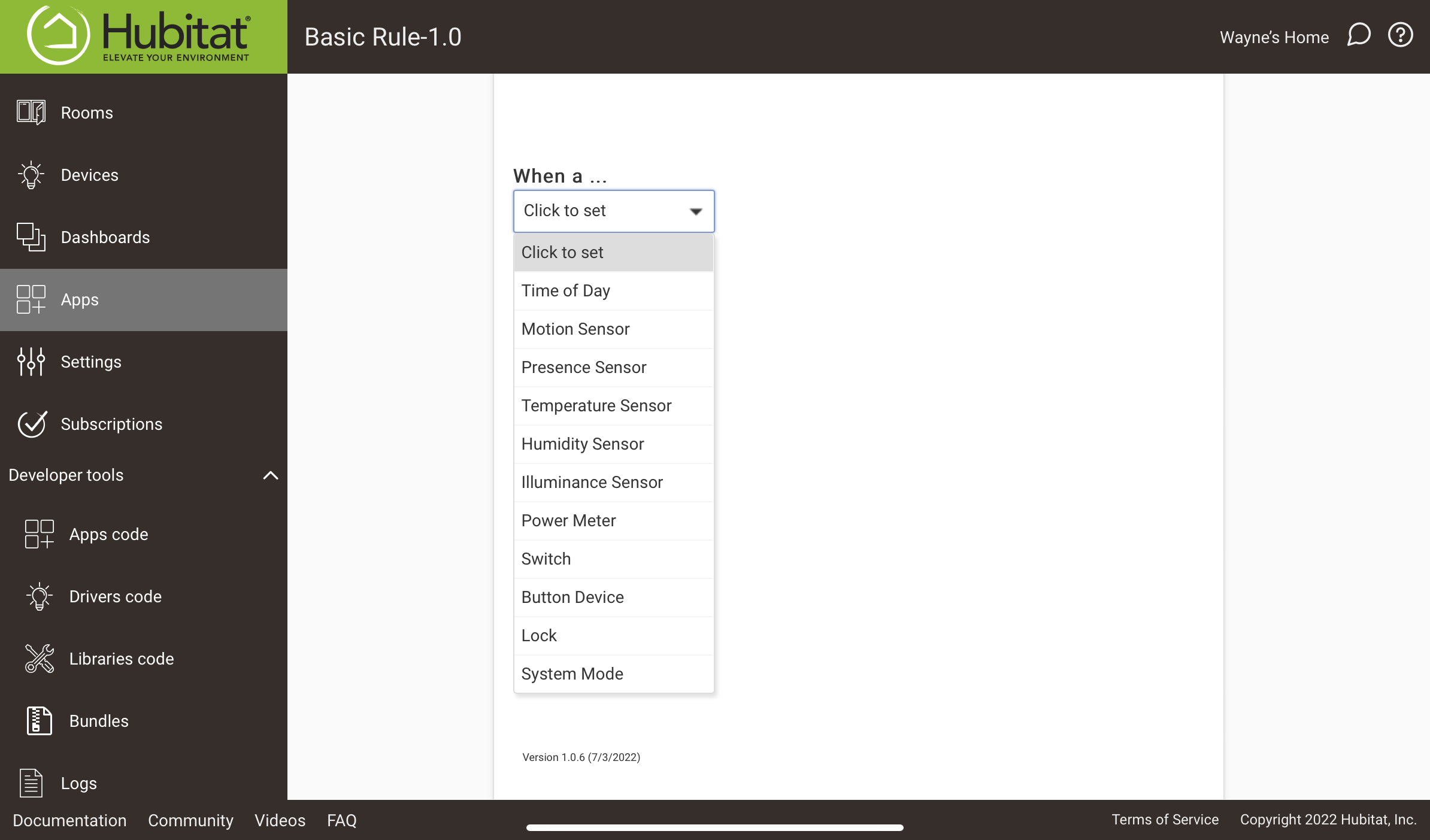

I am sure I am missing something - I do not see how to pick a date using rule machine. I can pick a time but not a date..
My bad...that was me assuming Basic Rule could handle date triggers without really looking. :smiley: So, two Rule Machine rules like I ended up suggesting might really be the best way. That screenshot is Basic Rule, not Rule Machine, by the way, so we are referring to a different app for this other scenario.

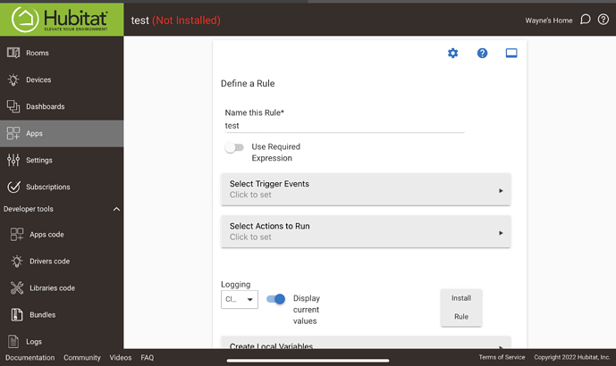

i created a new rule using rule machine like this…
i select trigger events like this…
i selected time and optional date. i selected nov 12at 00:01 am as shown here
then i select
then this.
Am i getting close?
Sort of. :slight_smile: The trigger looks good. There is no need to manage or create conditions (those are for using in conditional actions and other places you can use expressions--not needed here). Just go straight to actions and add an action to set your variable, mode, switch, or however you are implementing this in your system. Should be doable in just a single action.
Be sure to hit Done or Install Rule when you're finished.

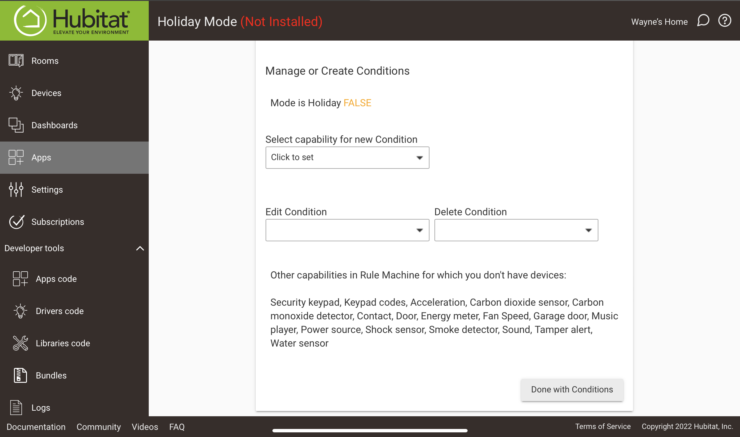

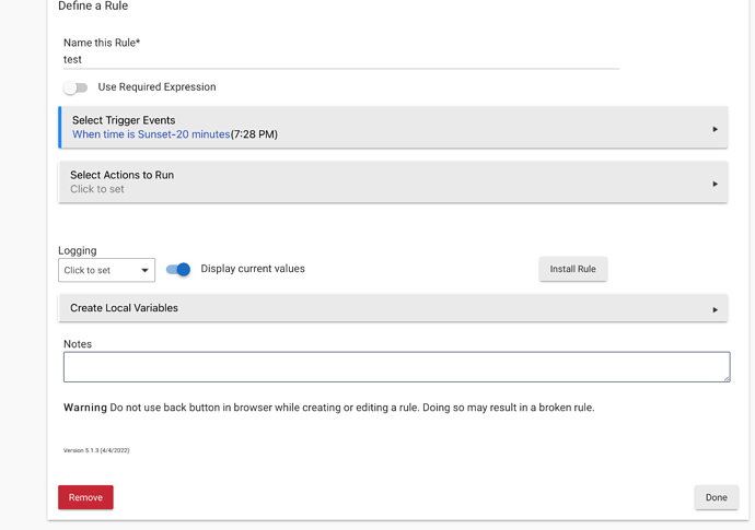

CRAP - I get stuck at the
I got this step-
Then this step -
But I do not know where to go from here. If I select done with conditions it takes be back to here -
If I click back into actions to run, I am back where I started from...
Damn I think I figured it out! Not sure I can repeat it, but I got it.

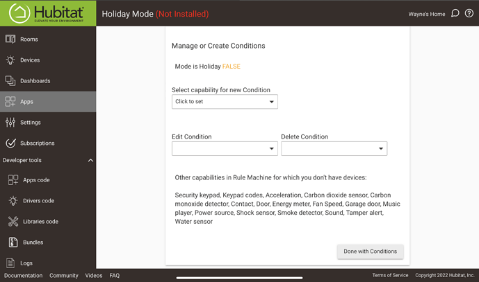

@bertabcd1234 I do NOT need this stuff correct?
They don't matter, except that you definitely can't get rid of one because you're using it. They don't do anything on their own; as the text above hints at, it's basically a bank of conditions you can use (or are using somewhere, like you are in that IF), and it provides a single place you can edit them without needing to edit or recreate the action, but just having something there has no effect on its own.
