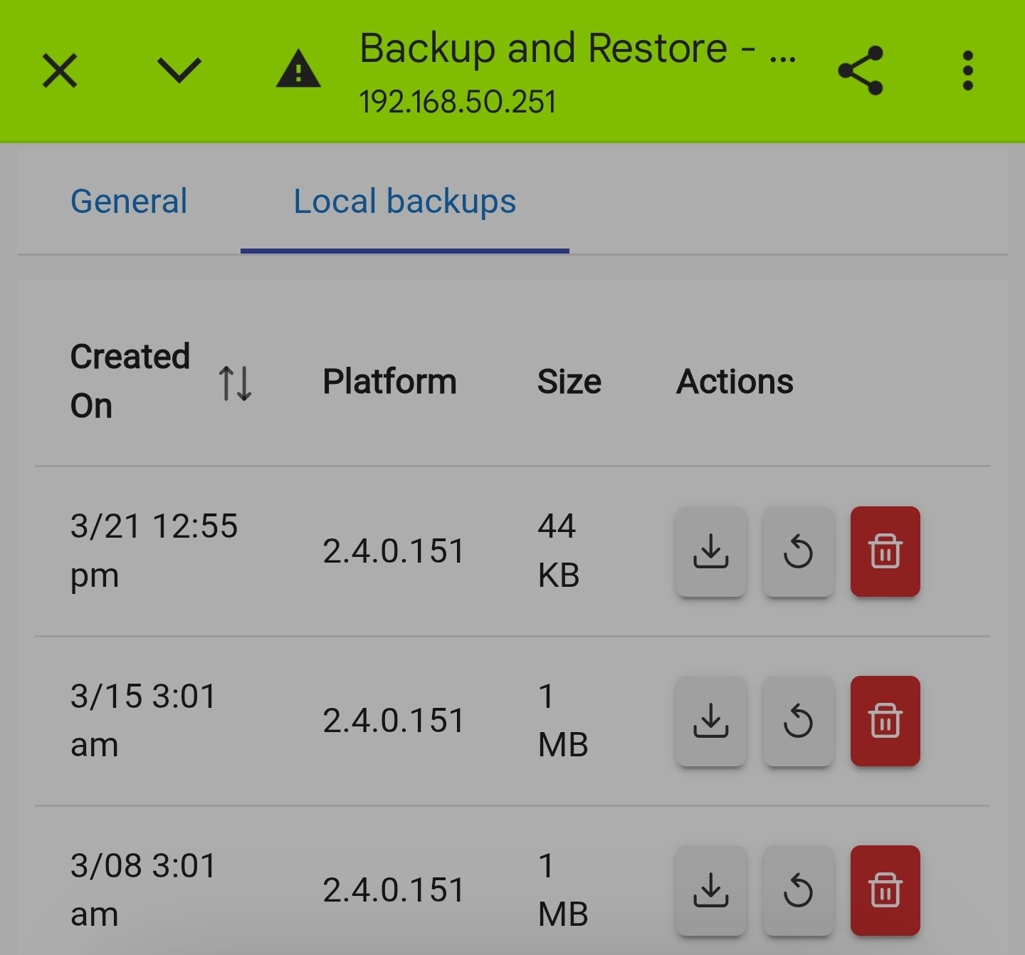

How long should restore take? Been over 5 minutes already still says restoring. I have a very small network. Nervous
I chose the latest local backup but just noticed the size is was smaller than other backups... See
That backup is probably hosed.
I would actually download all the backups you can before doing anything else, just in case more get made you don't want it to wipe out all your good ones.
Then just go down the list newest to oldest and see if you can get one to work. I suspect that 3/15 one will work. Hopefully you have not added any new devices since then?
Sigh.... Yes, the 3/15 backup restored (and i did have them downloaded). I probably made a few minor app changes since 3/15 but no new devices and I don't think any new apps.
